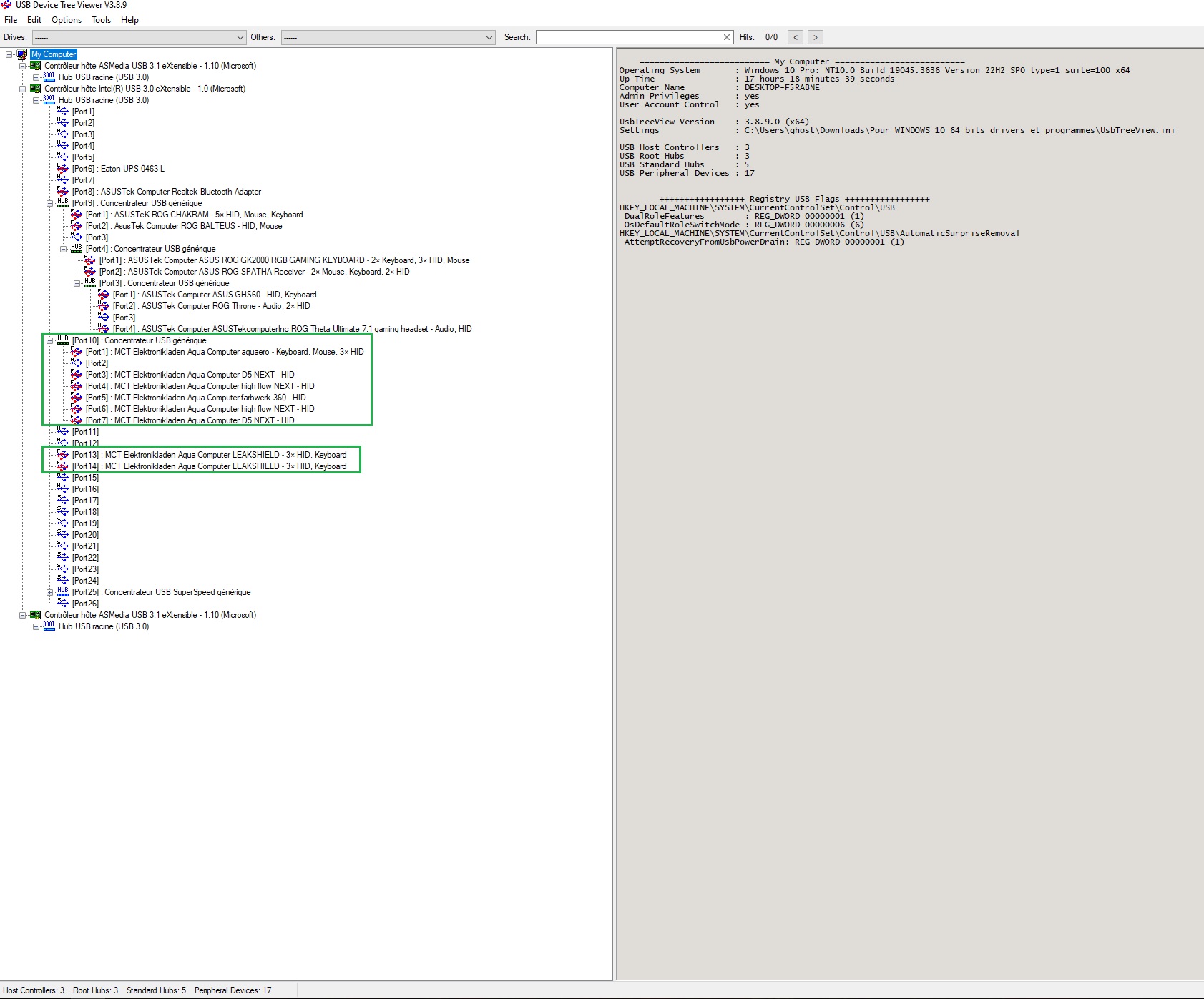

When i say the jumper is in good position, if i connect my Hubby7 on USB cable the jumper is in position 1/2 and position 2/3 for SATA power but if i understand what Sebastian write i need
to buy an adaptator to use my Hubby7 with SATA power but i never see that on the manual.
I know for internal USB port, i have the manual for my motherboard. But now i know the problem from the ROG forum. I have only one USB port 9-pin headers called USB1314 where i can connect
two different devices and the USB port called USB10 is just a unique USB port where i can connect only one device on the down pin header because the up pin header there is no function.
As we can see on the screenshot from the software USB device tree viewer
This USB10 is to connect this sort of device Dual USB 2 PCI bracket
If i have 2 Hubby7 is just question for cable managment and have one hubby for one loop, I have a Ultitube 200 pro leakshield each side of the case and it's more easy for me. This is why i want
to connect all devices for a loop to one Hubby7 with SATA to have more power.

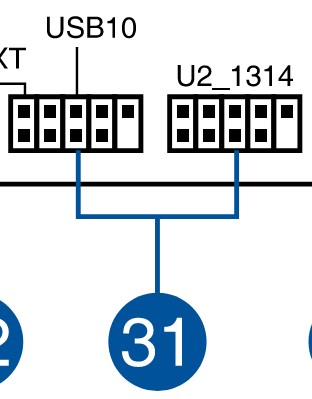

But now i know the problem from the ROG forum. I have only one USB port 9-pin headers calledUSB1314 where i can connect two different devices and the USB port called USB10 is just a unique USB port where i can connect only one device on the down pin header because the up pin header there is no function.
I don’t think the advice you got on the ROG forum is correct because the manual for your motherboard clearly shows that the USB10 header is wired just like the U2_1314 header. Personally, I would trust the Asus manual. The Dual USB 2 PCI bracket you linked has a 10-pin USB header on it so it would require a fully wired USB header for both of the ports to work.
If i have 2 Hubby7 is just question for cable managment and have one hubby for one loop, I have a Ultitube 200 pro leakshield each side of the case and it's more easy for me. This is why i want to connect all devices for a loop to one Hubby7 with SATA to have more power.
I still recommend that you connect 1 Leakshield to one port on USB header U2_1314 and the other Leakshield directly to a port on the USB10 header. You can then plug each of your Hubby7s into the other port on each USB header. This way the Leakshields pull power directly from the mobo USB headers instead of through the Hubby7, and those USB ports should stay powered up when your system is off (assuming you disable USB Selective Suspend in the Windows Power Management settings) If you set the Hubby7s to SATA power and plug the Leakshields into them, the Leakshields will lose power when you turn off the computer. It’s up to you. Good luck with whatever you decide.
The pin-out diagram you linked shows the upper port on USB10 having +5V & ground, but the data pins show NC (PIN-OUT)
Citation de "Speedy-VI"
The USB-Tree GhostR1d3r linked shows one leakshield on USB13 & the 2nd on USB14. The D5s were not on the original list, but it looks like s/he has what s/he wants. (USB_DEVICE_TREE)

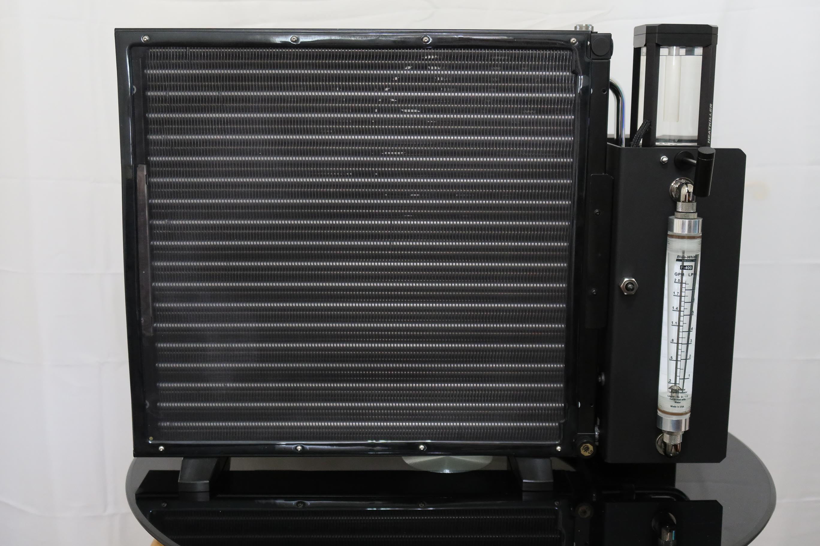

It looks like you have already done this test, and I am impressed with your setup. I see that you have a Blue-White Acrylic Flow Meter. I can’t quite make out the model number but think it’s an F-400. Is that correct? I am curious how the High Flow Next readings compare to the Blue-White. Also, has Aquacomputer ever commented on the error introduced by the flow meter’s electronic's waste heat?
Yes, that is a Blue-White F-400, dual scale (0.2-2.0 gpm & 1.0-7.5 lpm) with 3/8 npt ends. The flow rates were close. The rotameter is published at full scale accuracy of +/-5%. (front.jpg)
Wow you’re right, and so was the info OP got from the ROG forum. Apologies for the confusion. I wonder why Asus would do this, especially on an X299 EATX high end motherboard.
Thanks for the details. I may get one of these to play with.
