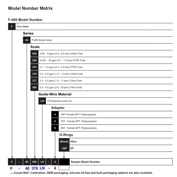

I am curious about the flow meter and the fittings that screw into it. IIRC from another post, that is a Blue-White F-400 series. I am considering buying one of these and have been reviewing their documentation. I think the model I want is the F-40_376_LN-4. F-400 Model Niumber Matrix.jpg
F = Flow Meter
40 = F-400 Acrylic Body
376 = 0.2 - 2.0 GPM (or ~1.0 - ~7.5 LPM)
LN = 316 Stainless Steel Rod
4 = 0.250" Female NPT, Polypropylene
Blank = Viton O-Rings
I am curious about which fitting option you have and what adapter fittings you are using to get to BSPP 0.25”. The spec sheet lists 3 options – 0.250”, 0.375”, and 0.500” Female NPT. Standard water cooling fittings are BSPP 0.25” with non-tapered threads. I found THIS brass adapter that is NPT 0.25” Male to BSPP 0.25” Female. If I got the flow meter with 0.250” NPT female threads, this fitting NPT 0.25” Male end would screw into the top and bottom of the flow meter and a standard BSPP 0.25” male fitting would screw into the BSPP 0.25” Female end. I also found THIS nickel-plated brass fitting that is also NTP 0.25” Male to BSPP 0.25” Female but it says it’s for hydraulic hose and I am not sure if the threads per inch are correct. It says the BSPP Male threads are 18 per inch but I think standard water cooling fittings have 19 threads per inch. Can you share what fittings you used with the flow meter?

I am curious about the flow meter and the fittings that screw into it. IIRC from another post, that is a Blue-White F-400 series. I am considering buying one of these and have been reviewing their documentation. I think the model I want is the F-40_376_LN-4. [attach]10577[/attach]
F = Flow Meter

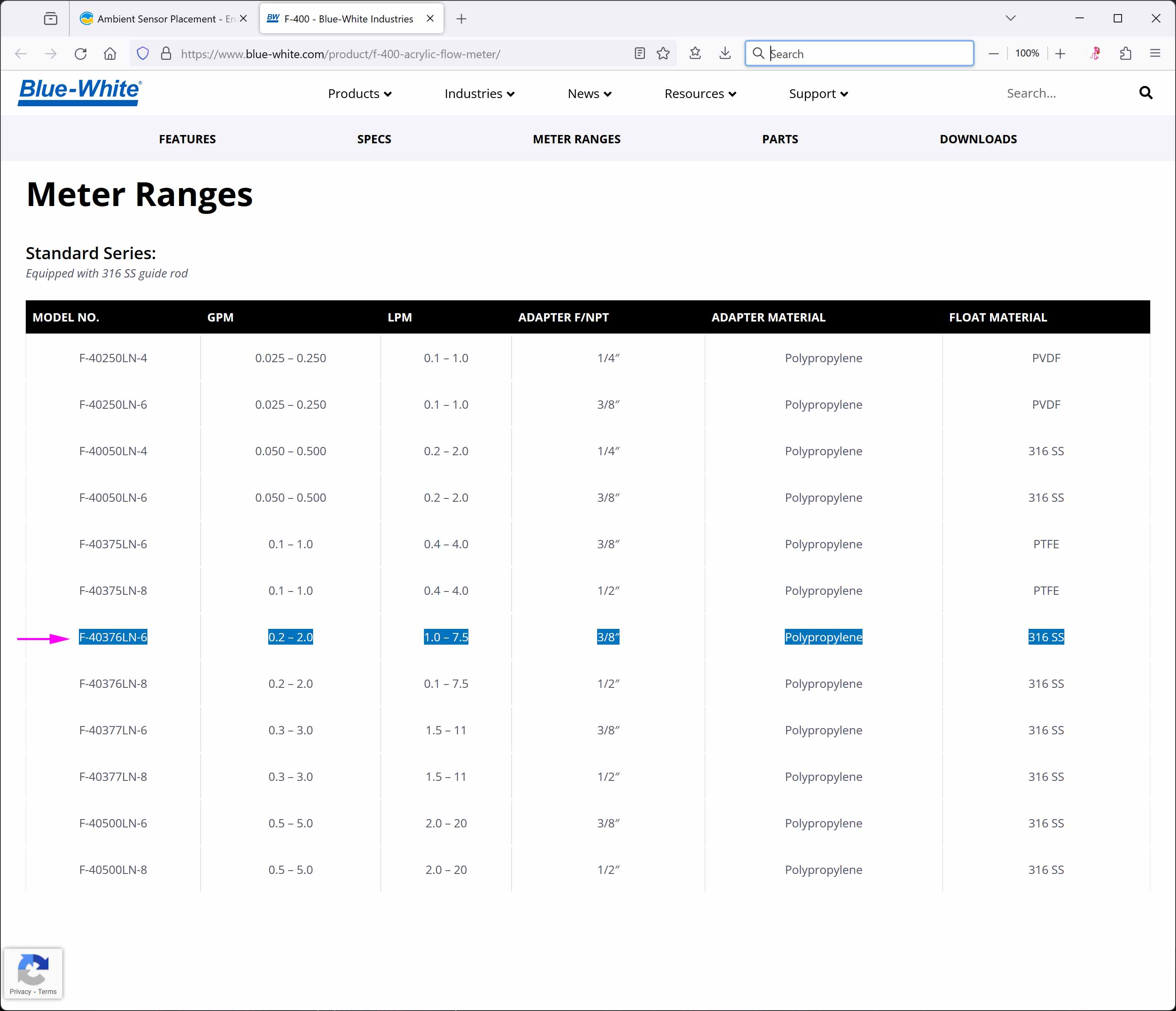

That is correct, except I don't think every combination is an available option
The unit you specified does not appear to be available with the 1/4" F/NPT end connectors, either 3/8" or 1/2" are listed
I went with model F-40376LN-6 (3/8" F/NPT) (f400.jpg)
I went with model F-40376LN-6 (3/8" F/NPT) ([attach]10581[/attach])

Thank you for this information. I am in the southeast US and also found Fresh Water Systems in a Google search. They do list the -4 version with 0.250” Female NPT LINK. It is out of stock but says More Expected Soon. It costs ~$11 more than the -6 version with 0.375” Female NPT for some reason.
I believe the flow rate is different for the one you linked (0.025 - 0.25 GPM / 0.1 – 1.0 LPM)

I also found it HERE but the -6 and -8 versions seem to be much more common. I wonder if the 0.250” Female NPT fittings obstruct flow rate more than the 0.375” or 0.500” fittings.
It appears there are standard, in-stock units and custom built options. Had I been aware of the 1/4" version (F-40376LN-4) I would have purchased it. Though it is about $15 more at PVC Pipes & Supplies, the difference will almost be made up by not needing adapter fittings... plus less fittings is more.
Oops you are right. Thanks for catching that.
All of the options are Female NPT so I think an adapter fitting is required regardless of which size the NPT fittings are. You have to convert from NPT to BSPP. Are you suggesting that a standard BSPP 0.250" Male fitting may thread far enough into the 0.250" Female NPT fitting for the O-Ring to seal?
