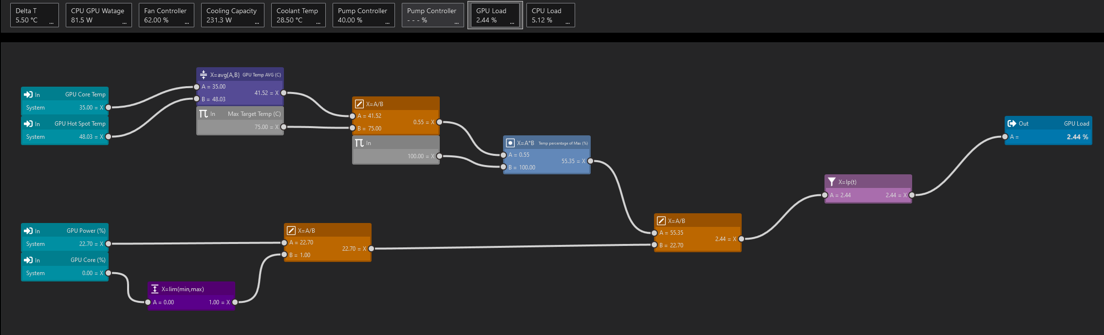

This is a virtual sensor I came up with to allow me to run two or more curves on the same profile for a fan or pump header. Within the sensor I can configure triggers so that the fan/pump will switch curves when system conditions are met.
As im not as versed in posting to this forum here is a reddit post linked with the guide.
https://www.reddit.com/r/watercooling/co…s_with_virtual/
CPU/GPU load virtual sensors for more data driven load values.
CPU
GPU
https://pastebin.com/ASTEEz3S
Pump controller V4.1 Virtual Sensor XML code for importing into auquasuite
It's constantly evolving and it has changed already since typing this... mostly just playing with filters lol.
Enjoy ! Hopefully some of you can find a use or share with me what you would change/improve.

DeathToTheWind
mardi 16 janvier 2024, 21:46
It was quite fun. And funny enough I did make a Rube Goldberg machine years ago.
The main reason besides experimentation was to develop a way of increasing the pump speed when it’s needed most and only then. Increasing flow rate will move more heat from components to the radiator. If the fans are maxed the only thing you can do is speed up the pump or lower ambient temp to gain additional cooling. In the case of fans it can be used to shut them off completely when delta T is a value you set for silent operation until load or temp increases. I currently don’t have a flow meter installed but am building a dual pump parallel x flow rad setup that will utilize two flow meter. Both before the manifold to ensure I can tune equal flowrates through the rads, should I decide to split the manifold through waterblocks of different resistance. Something like this allows me to take full advantage of the higher delta T of parallel rads while also minimizing restriction for all the QDC’s. It’s a custom case I’m building in solidworks for minimal footprint and ease of maintenance. It needed an overkill virtual sensor to go alongside. :D
Creating this sensor also seemed less daunting then setting up two or more profiles to switch back and forth on conditions. But I certainly could use this to drive outputs and switch profiles and achieve the same result. It is much easier to tune it all being integrated into a single virtual sensor, less confusing as well.

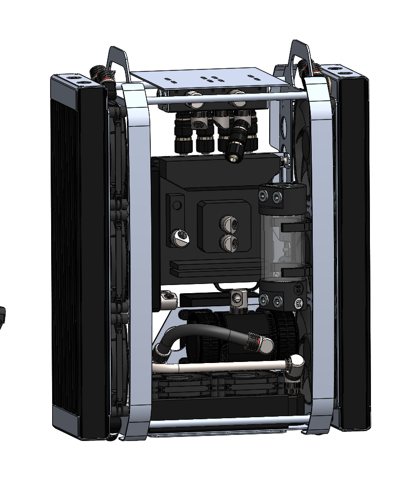

In the build I mentioned before, I am taking steps to optimize coolant paths, using larger tubing and fittings to minimize frictional losses before they split, which halves the flowrate, then flowrate is further divided by the number of coolant paths in the radiator. All tubing lengths for parallel runs will be equal.
If I have a flow of 220lph, that then splits and becomes (65lph split again lol) 110lph entering the rads, then 6.875lph passing through the rads before becoming 110lph again in the end-tank, and 220lph again when all combine in the manifold. (or stay at 110lph if I divide the manifold)
Flow meters and ball valves will allow me to equalize the parallel flow should I split the manifold. There will be water blocks on almost everything and about 8 QDC's, hence dual pumps and the virtual sensor to boost the pump when system conditions dictate its needed.
Its overkill AF and somehow I'm cramming it all in to the volume of a Mini ATX Case with movable maintenance features while keeping an airframe inspiration. Once the coolant is routed aluminum cover panels will be made to look like WW2 fighter aircraft skin complete with aircraft rivets.
2x 420mm rads and 1x 92mm rad, with option for external rad once done
Routing the coolant pipes and planning all the 3D printed cable guides to keep features is proving challenging lol... but I will make it work.
If machined or welded parts need to be made, that is no problem.
