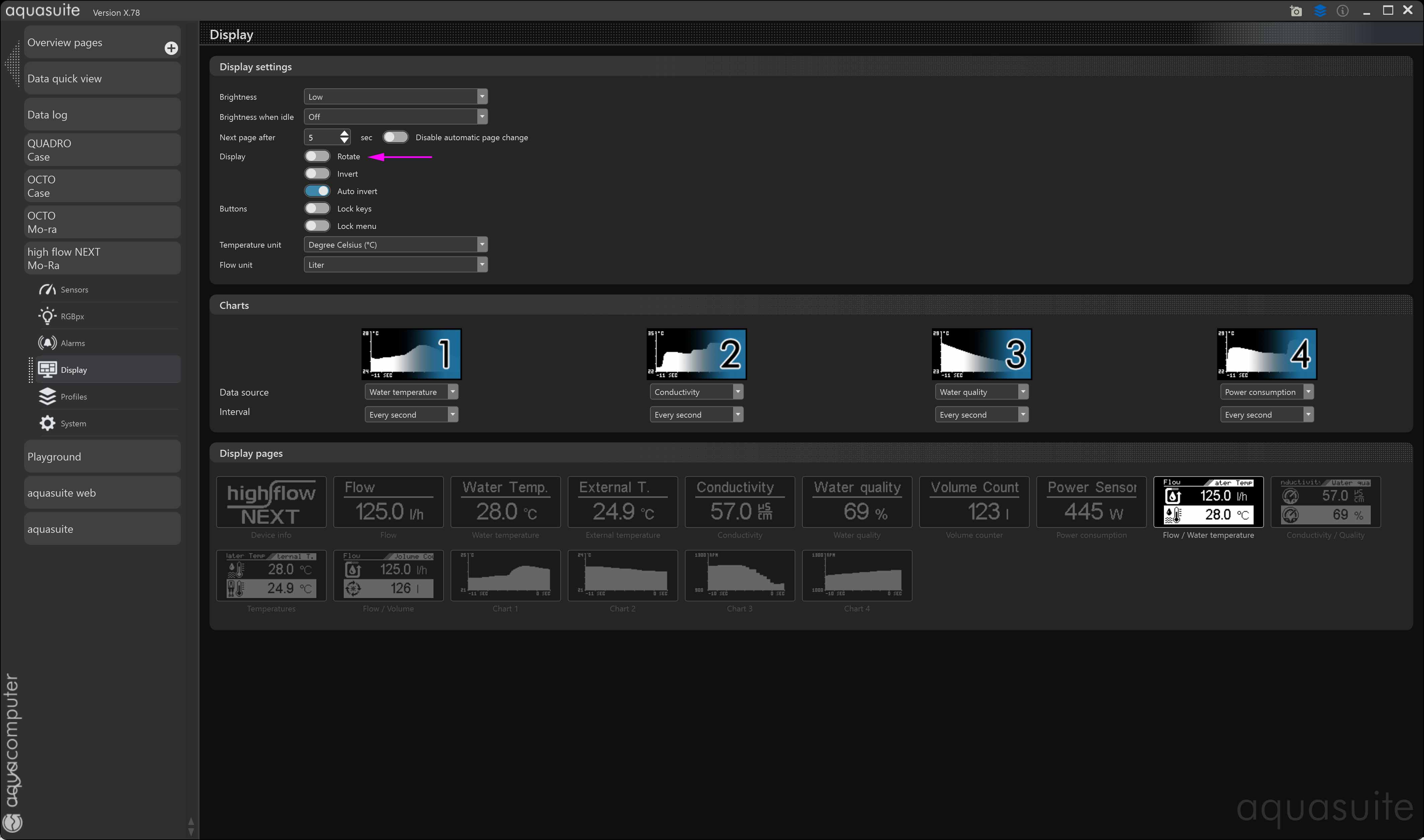

I do not believe having the Flow Next in your current orientation is an issue, as the device allows you to rotate the text 180°. rotate.jpg
