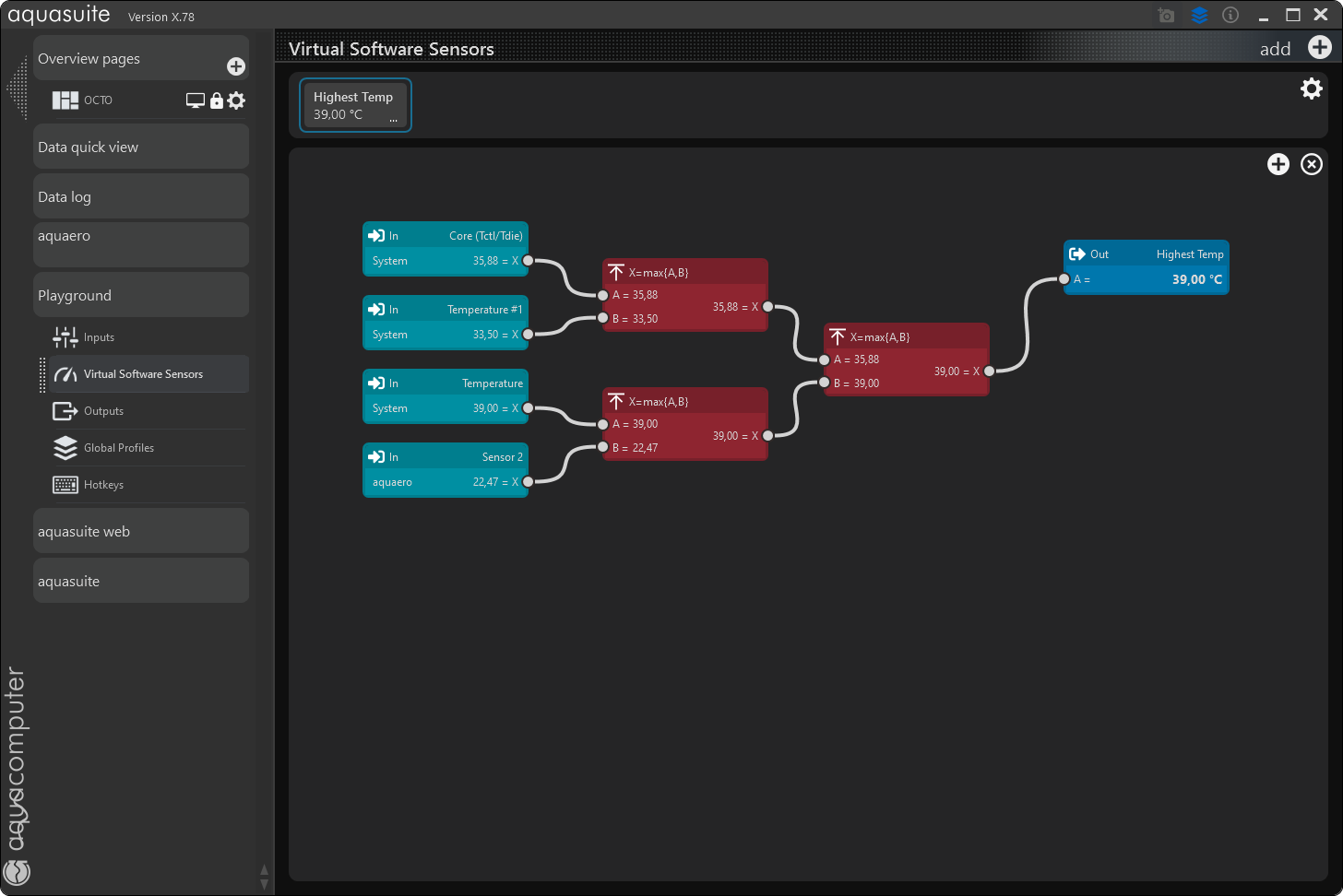

new question. is there any way to make more software sensors? i need 2 more.
and then i need to combine all the sensors. I found the ones that let you pick 4 and have the highest temp be the one that they use but it only allows 4 and there is only 4 of those sensors meaning you can only combine a max of 13 it seems 4 on the first one then 3 on each consecutive one as they need to take data from the previous one too however there are 14 sensors total is there any way to make those virtual sensors that combine them take all 14? or have 1 more virtual sensor to cascade the others into it?
lundi 8 avril 2024, 09:49
You can use a virtual software sensor to check for the highest temperature of multiple values. The result can be assigned to a software sensor of the aquaero.
meeeeeeeee
samedi 13 avril 2024, 06:42
cool i made one but cant find out how to attach it to the fan controller to control the fans. the virtual sensor does not show up in the list of selectable sensors. and i dont see anything in playground that lets me setup a fan group and attach it that way.
mditsch
samedi 13 avril 2024, 08:12
tested it and it works in that way:
1. create a virt. temperature sensor in playground (each in playground created sensor is always a virtual snsor)
2. create a Software Sensor for the aquero
3. make it active (only with making it active you can assign a sensor
4. assign the virt. sensor from #1
5. create a controller (in german: Regler) for the aquero
6. assign the SW Sensor from #2 to the the controller frrom #5
that's it
