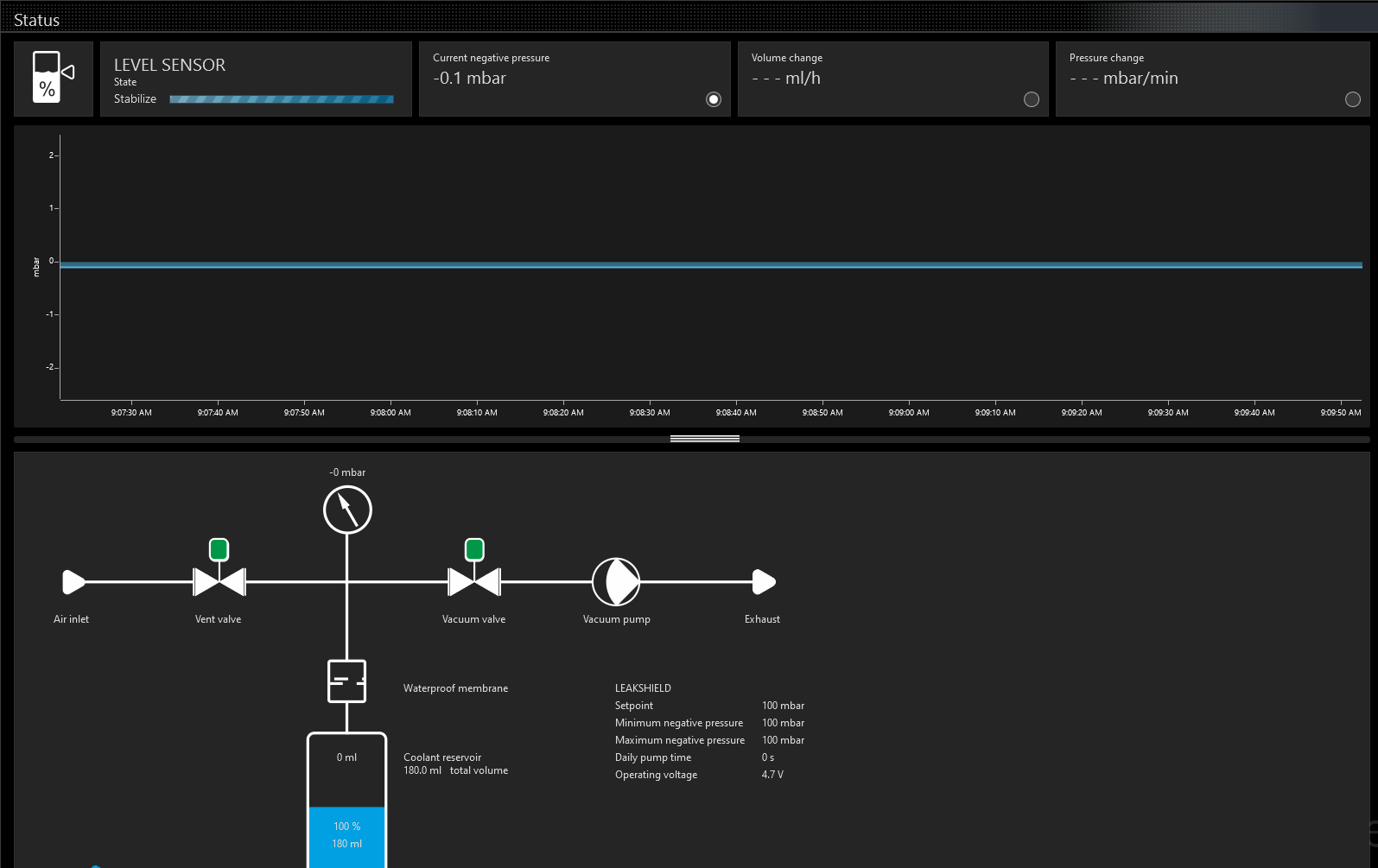

Hi everybody,
Im posting here today because my leakshield is acting strange.

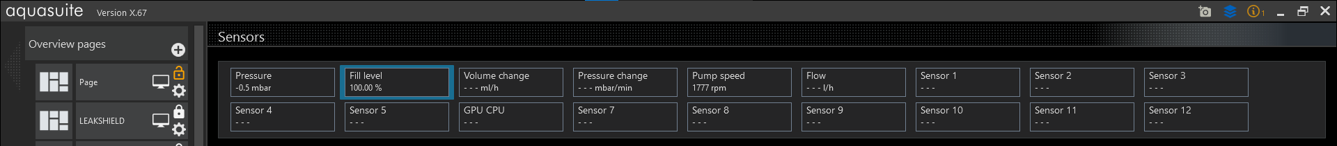

I have had it working for about 2 years, and a couple months ago it started failing I think. Strange how? It doesnt seem to be maintaining negative pressure, and suddenly thinks that my resevoir is 100% full. It thinks it is protected (shield status) but it has not got any pressure so its failed somehow.
How can I find out what is wrong with my leakshield.

Yep you were right. I ran the test and it failed the following.
