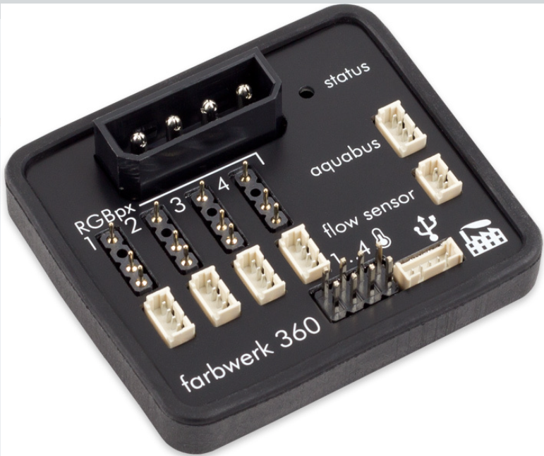

That Farbwerk360 in your photo must be an older one. A few years ago they rearranged the 4 x RGBpx port headers in a row and added the standard DRGB 4-pin male headers above the RGBpx port headers. I bought mine in 2021 so its been at least that long since they updated it. The attached product photo is the current version of the Farbwerk360. I would use the RGBpx port headers, cables, and adapters anyway because the standard DRGB 4-pin connectors suck so much. I read one problem is that there is no real standard for the diameter of the pins and the sockets, so a female DRGB connector from brand A may not mate properly with the male pins on a cable or device from Brand B. EK even makes a Velcro strap called the EK-Loop CMS to prevent mating pairs of DRGB connectors from falling apart. I have used the Aquacomputer #53282 and #53285 adapters and they mated quite snugly with the DRGB connectors I was using. Whether they will mate snugly with the DRGB connectors on your Be Quit fans is anybody's guess.
Tip - Adafruit product ID #4924 1.25mm Pitch 4-pin Cable 20cm long 1:N Cable - Molex PicoBlade uses the same Molex Picoblade connectors as the Aquacomputer RGBpx cables. They also have mating pairs to bare ends, Product ID #4722. Both are 95-cents each. I think they only have them in 20cm length and I think they are pinned the same way. Standard Picoblade cables are wired "mirrored" so pin-1 to pin-4, pin-2, to pin-3, pin-3 to pin-2, pin-4 to pin-1. RGBpx cables are wired 1:1 so pin-1 to pin-1, pin-2 to pin-2, pin-3 to pin-3, pin-4 to pin-4. The Adafruit cables are also wired 1:1. For Aquacomputer RGBpx cables, Red is +5VDC, Black is GND, White is Data In, and Green is Data Out. RGBpx port header pinout is shown in the 3rd picture. Hope this helps!
