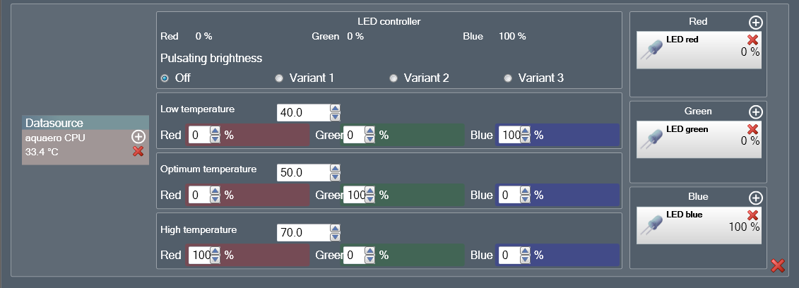

I have an Aquaero 5 LT running Aquasuite 2012 beta 12 and can not get the RGB LED to function correctly. As a test I've set up the LED controller to use the Aquaero CPU as sensor with the red, green and blue LEDs as the output. I have a true RGB LED that I've tested to make sure all three colors work correctly. This is wired to a 4 pin plug and plugged into the LED controller.
After some testing I quickly found out the user manual appears to be wrong. It shows pin 3 as ground when it is actually pin 4. Pin 3 is the Blue LED.
Setting the temperatures so that only one LED will go to 100% shows my Blue LED works fine. Green has the LED light blue but very dim. Red does not work at all.

Attached are pictures of my LED Controller config and a LED itself.

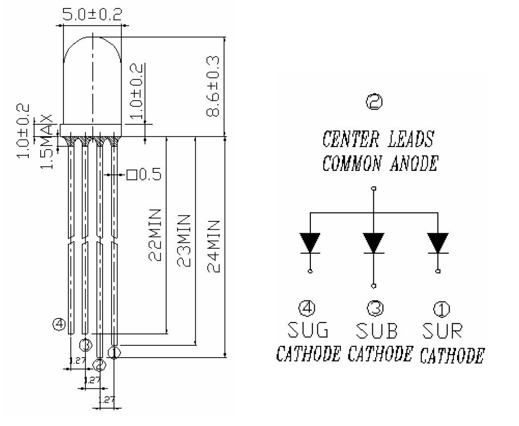

This is the LED that I have:
If I understand you correctly then, my LED is backwards from what I need as this one has a common anode (+) and 3 different cathodes (-) ?( ?( ?(

Your Led is not working with the aquaero.
You need an LED like this: http://www.sparkfun.com/products/105

Well, crap.
You're right. My LED is exactly backwards from what's needed. The sad thing is I actually looked at those LEDs at SparkFun but decided to buy them local instead. Should have been more careful.
