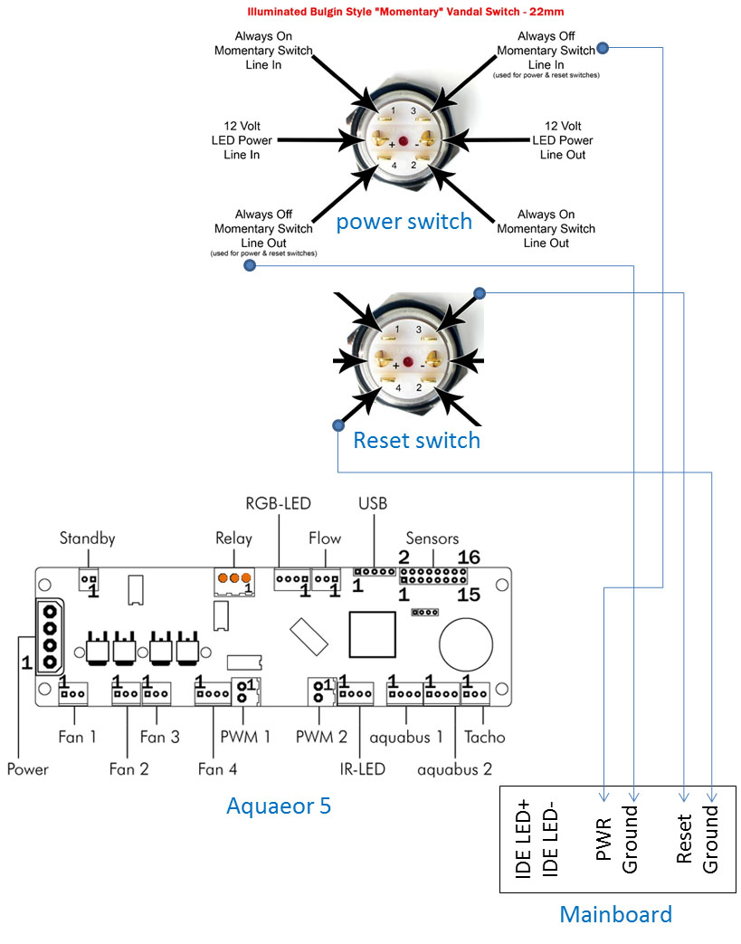

I have 2 switch on my case power and reset, but I'm not sure how I can connect the wires to the relay? so I can powering the PC up/down, standby and reset by aquaremote or emergency shutdown the PC?
I'm already connecting the USB between Aquaeor and Motherboard..

Is this correct?

Try to think about it. Why do you think, there's ONE Power switch and ONE Reset switch...that makes TWO independent switches. If we use your logic there's the need for only ONE switch to operate both functions separately, but that's not possible. When you connect both functions 'reset' and 'power on' to ONE relay it's the same 'in green'. Both functions would interfere with each other.
lundi 3 décembre 2012, 08:00
You cant connect Power and Reset.

So can not connect the two functions together..
Without connect the wires "Reset Switch" to the "Relay" Is the rest of the connections are correct? Rely Pin 1 & 3 > Power Switch Line out & Line in
I will be connected wires directly to Mainboard pins (Relay>Switch>Mainboard) without the ATX break: 53047 .. And I want to use two switches because there are two holes switches in my case and I do not want to keep one of them is empty!

this way right?

I would favour that.

About relay pin 1&2 or 3&1 if will be direct connection to the power button?

You can look into the Aquaero 5 manual chapter 4.12. Connector Relay.
Pin 1: normally open
Pin 2: normally connected
Pin 3: common connector
If you use Pin 1 and 3 you have an open connection witch will be closed when the relay triggers. Useful for operation as a power switch.
If you have the pin 16 cable of the Aquaero ATX connector connected to the pins 2 and 3 of the relay the connection is closed as long the relay doesn't trigger. When the relay triggers it opens the connection between Pin 2 and 3 of the relay and also the cable connection of the pin 16 of the ATX connector between PSU and Motherboard is cut off. The result is an instant shut down of the PSU.
