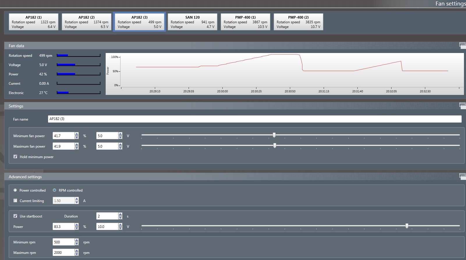

Pilo, I have the waterblock for my aquaero attached with the supplied thermal pad, integrated into my loop. I created a graph to monitor the temperature of fan amp 3. At 6.6v fan amp 3 is settling at about 37.5 degrees. Fan amp 1+2 runs at about 45 degrees with two ap182s running at 6.6v which I think leaves me plenty of headroom, does it not?
This is what happens to the fan amp temperature when I lower the voltage to 6.5
And this is the graph of power fluctuation I am getting when trying to run the fans using a controller curve, with a minimum fan power of 5v rpm controlled (from 23:32 onwards)

In the second screenshot under "Advanced settings" first line, the setting is "RPM controlled".
Have you tested it with the setting "Power controlled" yet? I would recommend it for all your fans.
Perhaps that's the reason your fans are showing such strange behavior. Just a guess, though.

Today I attached the supplied fan controller to the third fan, and connected the rpm wire to the aquaero 5 and it does indeed allow the fan to go at 500rpm, here's proof! I don't know what voltage this is unfortunately :(
