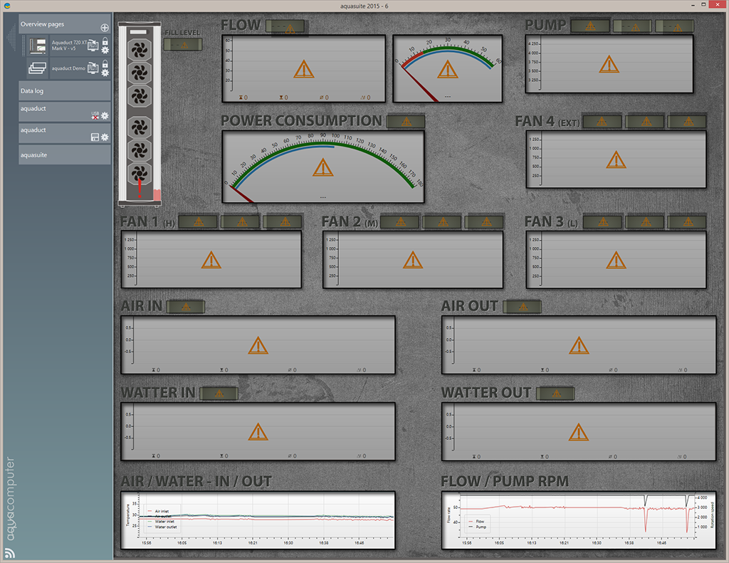

Hello,
I do not find a solution for my problem. I run manually "Aquasuite" everything works. Then after a while, "Aquasuite" freezes, and if I leave and I raise, he can not find USB.
I do not know what to do to find the problem.
All USB have the "power management" removed. The motherboard (Gygabite) and new.
Do you have any idea?
Thank you for your advice :)
Swiss720 a envoyé les images :

In my latest tests:
A - Aquasuite 2015-6 (+ service "Aquasuite" launched) + HWinfo64 = both freeze at a time :cursing:
B - Aquasuite 2015-6 (+ service "Aquasuite" launched) = freeze at a time :cursing:
C - USB cable disconnected to Auqaduct 720 + but Service "Aquasuite" launched + HWinfo64 = HWinfo64 no longer freezes, it works perfectly :)
At first I thought it was "HWinfo64" which was freeze Aquasuite, I tested many settings in "HWinfo64" and then I had the idea of making my last test with the USB cable removed from my "720". So I can now say that this is not "HWinfo64" which raises the problem.
I also tried to remove in the BIOS, power saving as "EIST". Or in the "Power setting" in Windows put "5% - 100%" CPU use to "15% - 100%", but none changed the problem, ... freeze
Does anyone support can it happen here ? :whistling:

The problem is solved with the help of support (effective and very fast) of Aquacomputer :thumbsup:
It was the USB cable that was the problem, I changed to another and everything works perfectly hours (before, within minutes it was freeze)
