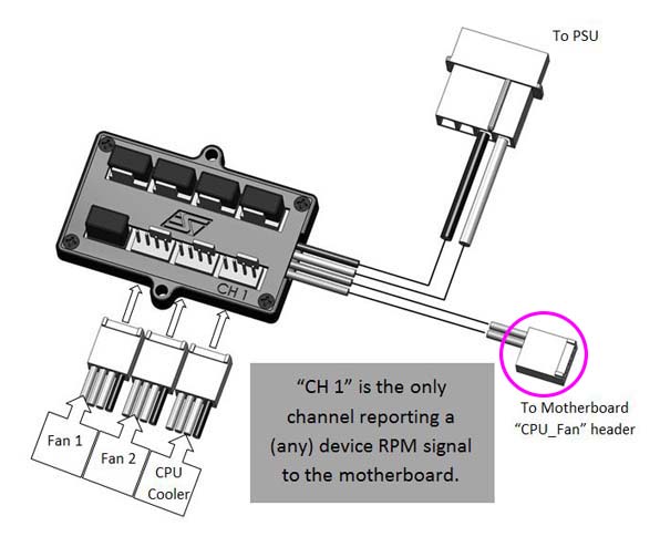

From one aquaero 6 PWM fan control port, I want to control 12 Noctua PWM fans on an external radiator.
Each fan pulls 0.18 A max, for a total possible amp draw of 2.16 A, or 86.4% of the maximum allowable load (2.5 A).
I am aware of someone controlling 6 of these fans from an aquaero 5 PWM port, but they are providing an external power connection to the fans.
I could also add a non-aquaero power source if recommended, but my primary concern is, will one aquaero PWM port comfortably reliably control 12 PWM fans?

Could I drive a Swiftech 8 way spiltter with one PWM port using a 2-pin cable, as long as power is also provided to the splitter?

Guess I'll try using a Y-Cable from one aquaero fan port into two of the Swiftech splitter blocks, with separate fan power to the blocks, and run 6 fans from each block.
