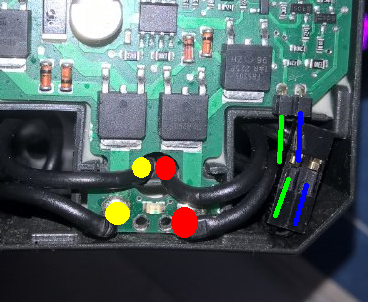

Barnack
vendredi 13 juillet 2018, 19:51
When you remove the controller board you can run the pump with a 9-12 volt AC (not DC!) power supply.
Greetings,
can you tell more specifically how many volt and amphere should i look for?
Between the colors in the picture which ones should i use to power the pump, which is - and which is +?
I'm guessing Yellow/red is to power the pump and green/blue is to control it? Not sure though.
Which color is what?
P.s. i know i could just buy replacement parts, but right now i'm going to have to move soon, still i need my computer for work... until now i used some lent laptops, now i need mine specifically.
vendredi 13 juillet 2018, 21:26
The pump has only two wires. They should be both black, on older pumps they were brown and blue if I remember correctly. Anyway, it does not matter because the pump runs with alternating current (=AC) so their is no specific polarity.
Are we talking about the same pump? The amount of wires and also the colors that you mention make no sense for aquastream pumps.
As PSU I would say you should get something with at least 2.5A.
Barnack
vendredi 13 juillet 2018, 21:42
sorry i didnt realize my picture didnt upload, i added colors in paint to distinguish the various wires.
But from what you've said i guess you're referring to red and yellow
Barnack a envoyé l’image suivante :
vendredi 13 juillet 2018, 22:35
Red and yellow are for the power supply. As said the pump works with AC. So if you use it without the controller board and connect it directly to a AC power supply, then the polarity does not matter.
Green and blue are the wires of the temperature sensor. Can be only used with the controller board. The polarity does not matter again.
