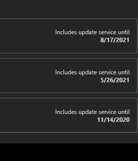

I was successful adding my new Octo to the aquabus on the aquaero 6 LT. I updated the FW on the Octo and have both the aquabus connected and the USB connected. One question is that I noticed the Voltage on Fan 5 which is the first fan header on the octo did not decrease in voltage as I decreased the power input after connecting a fan. Shouldn't the voltage decrease or is it locked at 100% because it's controlled via the Aquabus? I have attached a picture of the difference between Fan 4 on the Aquaero (which does decrease voltage with decrease input power) and Fan 5 on the Octo. Second, the update service expires 11/14/20? Only 6 months for this device? Is that correct? Thanks.
Note the other 2 devices are the Aquaero and the MPS flow meter.

I believe you are good until 8/17/2021 for your aquasuite license... it updates to the furthest out date.

So I will be ok on the license/software for all devices despite the dates I’m seeing. Thanks. That was a bit confusing. Appreciate the help!
