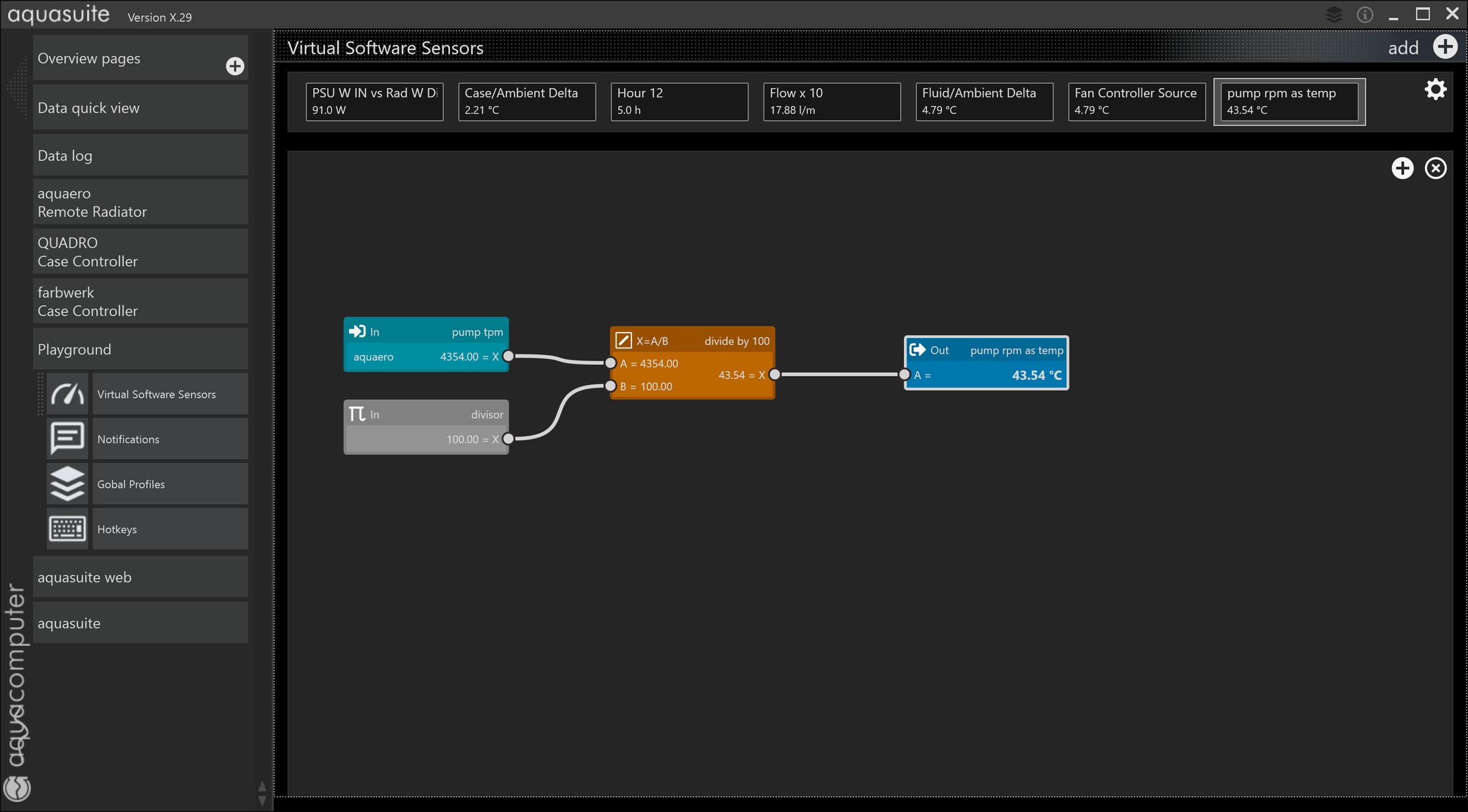

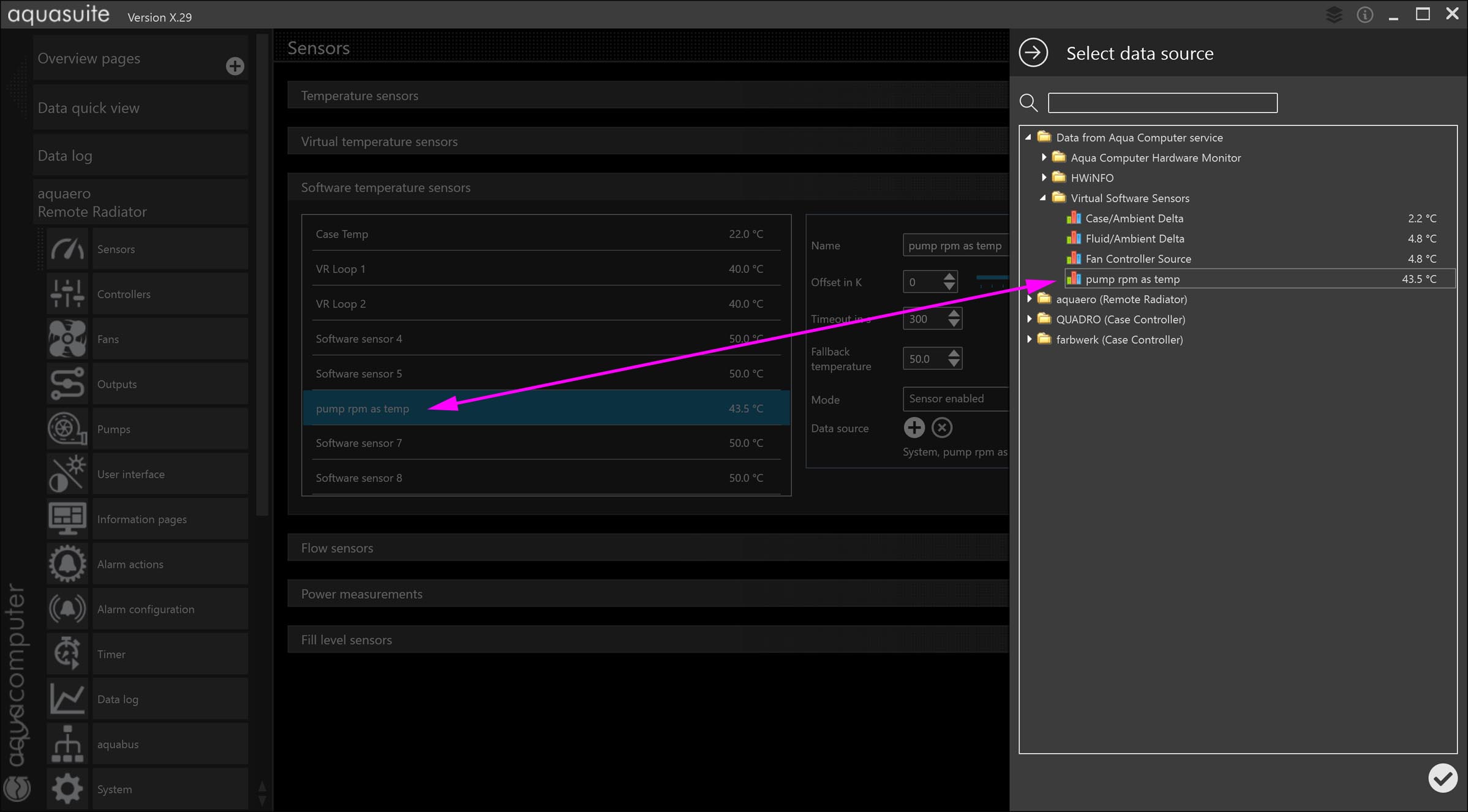

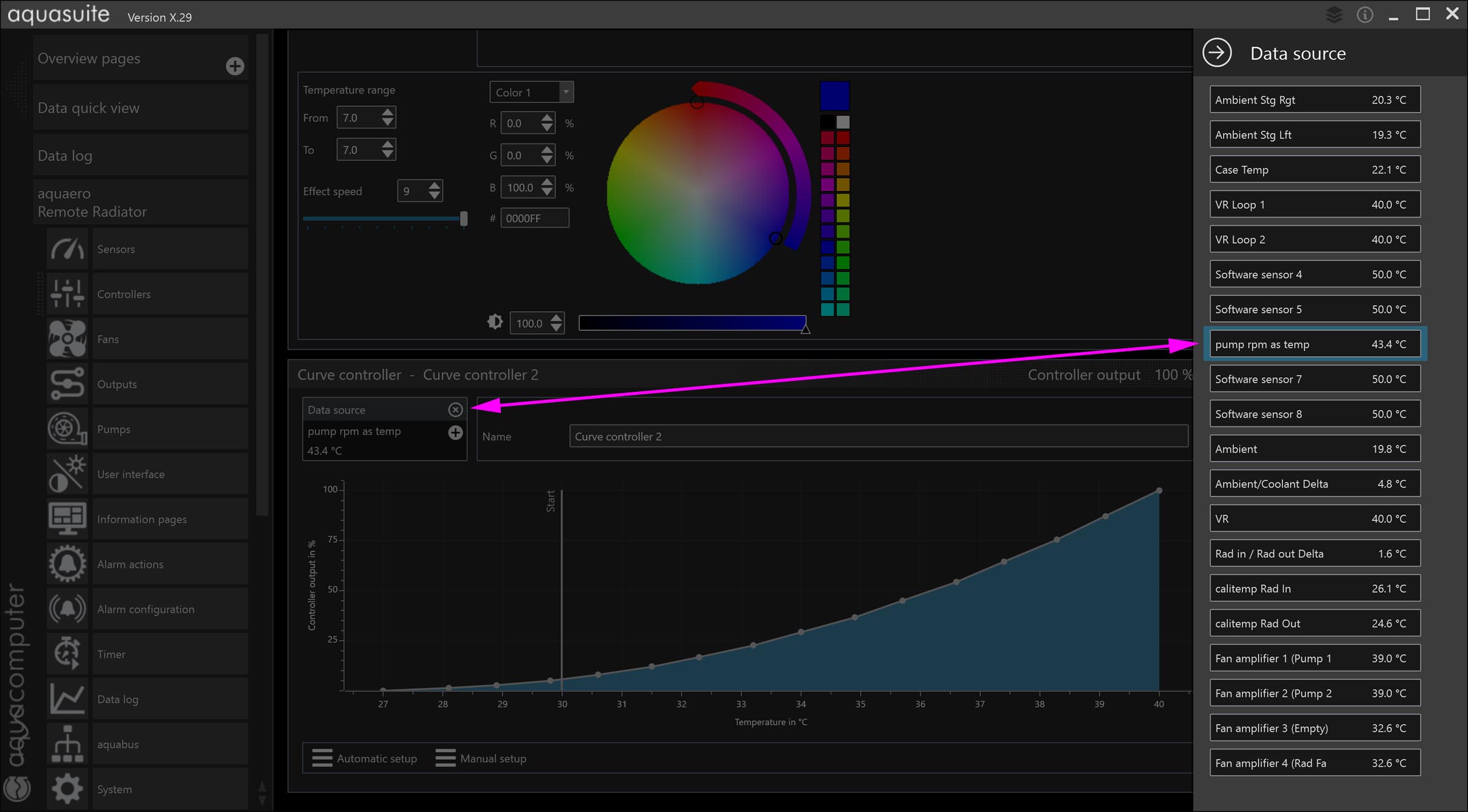

I believe curve controllers have a built-in limitation of only working with temperatures as the source.
You can get around this by converting RPM to a temperature in the Playground, and using that as the source:
But honestly, you are best off with a preset controller.

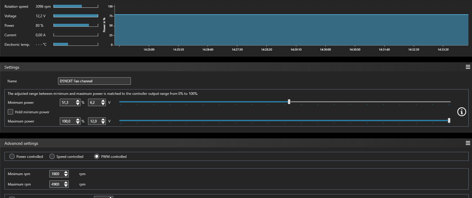

There should not be much issues besides "PWM controlled" is selected under aquaero - Fans - pump's channel - Advanced tab.
Make sure under Settings tab, the real Minimum and Maximum power are selected. The behavior you describe is possible if the same 100% is selected as minimum and maximum controllable range.
