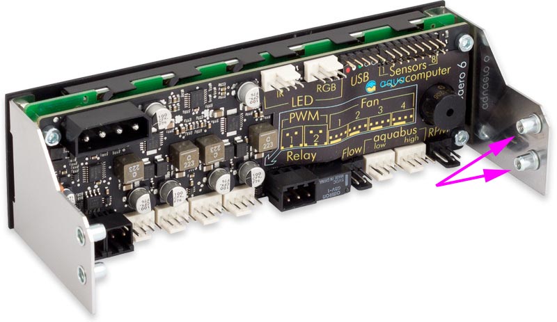

To mount/use the aquabus X4 on the aquaero you should request the 'short' screw mounts for the aquaero... I believe support can either supply them or advise what to purchase.Your op listed '15 Halo Lux Digital Frames', are they gone?
Alderaan
jeudi 4 mars 2021, 04:48
  • [attach]8214[/attach]
  • [attach]8215[/attach]
