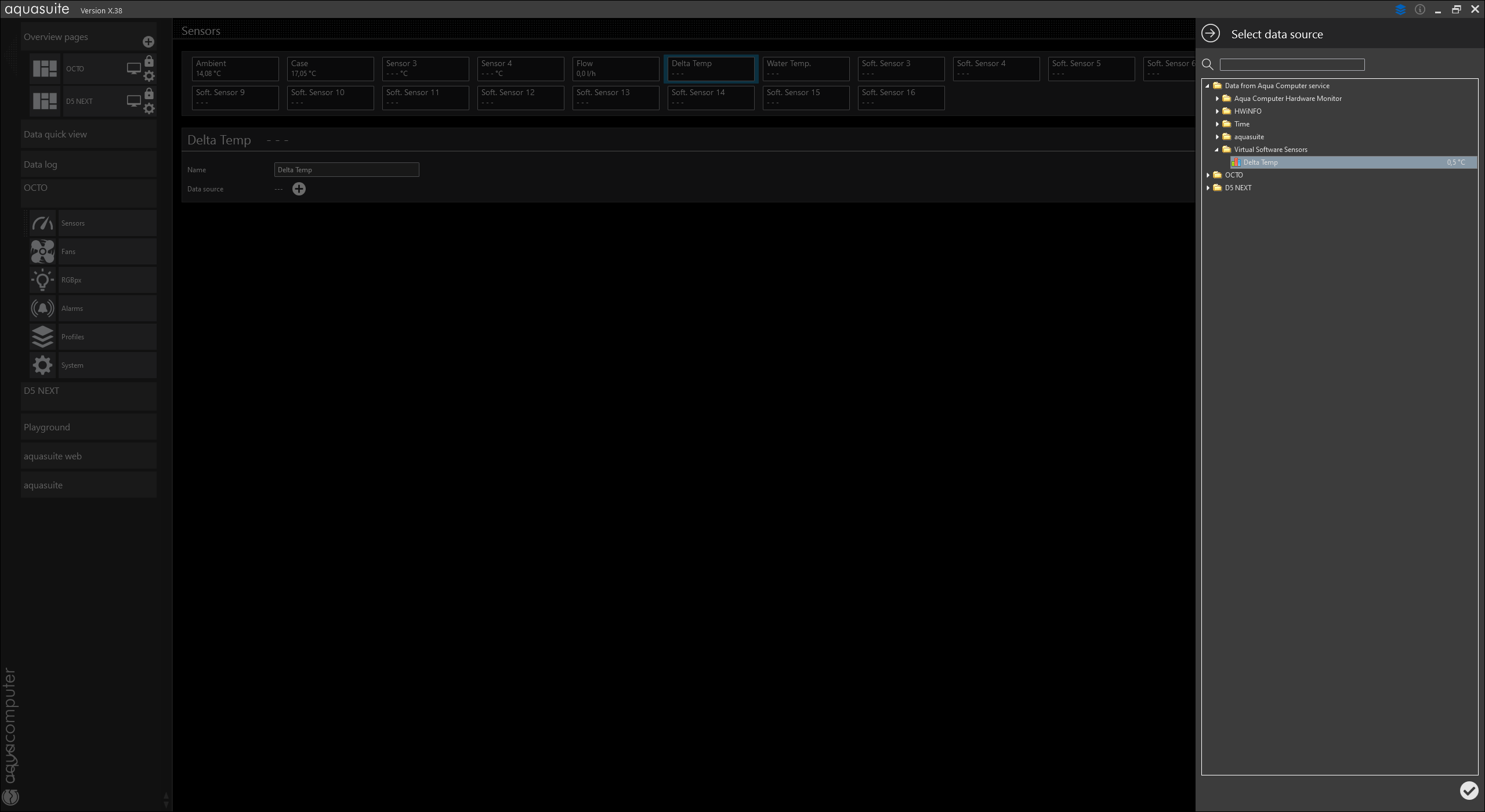

A week ago I've installed a new D5 Next in my system, and since then my Octo (inside Aquasuite) seems to be having some issues.
I can’t change to any of my Octo's profiles anymore and none of the software sensors have readings.
But, if I add the same sensor in the D5 Next I can see the value.
I've connected both USB cables to the same header (moved to another header already), and for what I've
checked my USB ports doesn't have 'USB selective suspend' enabled.
Also, I've restored each device to factory settings, removed Aquasuite and installed it again (X.38), nothing seems to work.
Any thoughts what could be the cause of this?

This looks linke an USB issue. Connect only the Octo and disconnect all other devices from USB.
Test the OCTO with an other Computer.

Thanks for the answer, after a complete clean (disconnected both devices, uninstalled Aquasuite, remove the USB Devices from the hardware manager)
I've reconnected only the Octo & reinstalled Aquasuite now it seems that it's working again. I've connected the D5 Next after.
Thanks
