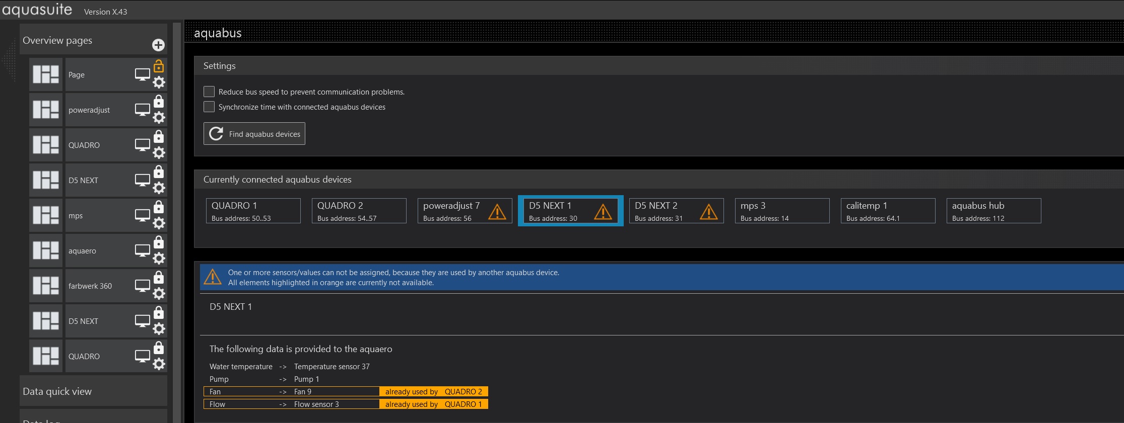

Thanks, yes it seems not needed, but Im now struggling with 2 Quadros and poweradjust, it says some fans on Quadro 2 are conflicting with poweradjust and D5 next, how to fix those? ?(

Have you ever looked in the manual of the Aquaero, there are detailed tables for the Aquabus.
Manual
hossam.sy
jeudi 26 août 2021, 20:05
Yes, there is no mentioning of how to change aquabus address of internal components of devices, and originally D5 next and Quadros have fixed address

Ah ok, I understand now, those yellow warning and conflicts I have to live with, and choose the priority bus to connect my stuff to, as there is a priority in internal components addresses and those conflicts cannot be resolved, but whay wouldn't they allow us to choose alternative free bus addresses, I don't think they are all busy?
Anyway, thank you for help.
Hufeisen
vendredi 27 août 2021, 01:40
The Problem is that the Aquaero can only handle 8 additional fan Ports with Aquabus.
Those 8 additional Fan Ports are already used up by the two Quadros.
You are unable to control the Fan Ports of the D5 Next and PowerAdjust. Thats why you get the warning.

Jacob, Im using splitty 9 to connect 5 of the devices and 3 others are connected to the aquabus 4 outputs that is attached to the aquaero, the problem not in the main devices, it is in the fans and temp sensors and flow sensors channels inside those devices.
Hufeisen, yes you are correct, the devices are connected to the aquabus with no problems in the connection of the main devices, only the fan outputs are conflicting because what you said is true, Aquaero can see only 8 fans.
The 2 D5 next have conflict because of the flow sensor in them if conflicting with the flow sensor on the Quadros.
The temp sensor in the poweradjust is conflicting with the temp sensor in the quadro.
Athough none of those conflicting outputs have nothing connected to them they are giving this yellow warning, although there is nothing connected to them.
I will just ignore those warning and maybe is there is a way to disable those outputs the warning can disappear.
