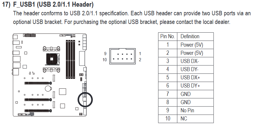

RBMDragon
mercredi 9 mars 2022, 19:59
The color of the GND (ground) wires on the USB are black.So pin number 7 & 8 on the USB 2.0 connector.
You can't really use the USB 3.0 ports, the pinouts are very different.
The small micropin is also a bit tricky. I however managed to push the connector in with the wires straight in.
Rule of thumb with connectors; if you have to 'force' it, its not oriented correctly.
You're right that the 5 pin is for USB, 4 pin is for RGBpx. The 3 pin is for shutting down power in the event of a major pressure drop.
