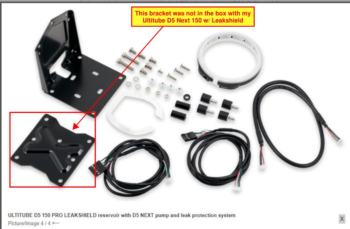

Now I just noticed that I appear to be missing one of the 2 brackets that is supposed to be included with the Ultitube D5 Next 150 w/ Leakshield. The bracket that I am missing does not appear to be available as a stand-alone product. I am not sure if I should reach out to the vendor I purchased if from (Titan Rig) or Aquacomputer directly. Mine came with the L-bracket #34111 but not the flat bracket with the "X" shape on it. I have attached a pic that shows which bracket is missing. Do you happen to know if this bracket is supposed to be included with the Ultitube D5 Next 150 w/ Leakshield? I assume it is since its shown in the included accessories picture. I am also not sure where it goes.

34150 is the number for the X one.
samedi 10 septembre 2022, 21:52
Thank you again! I just found the bracket that somehow got loose in the box and was wedged between 2 pieces of packing foam. I don't know how I did not see it earlier because I thought I searched that box thoroughly. I still can't figure out what it's for. The hole pattern matches the side of the L-bracket that sits under the pump. Maybe it attaches to that?
