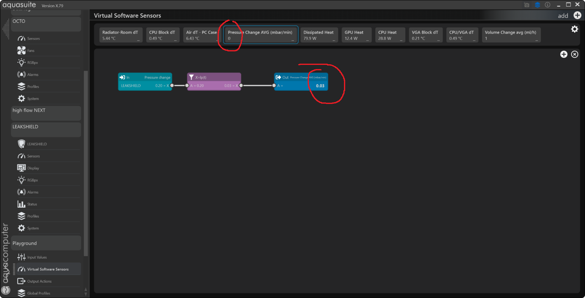

Hi guys,
I can't seem to figure out how can I set the any of the temperature sensors - virtual or physical - to show the fractions.
It rounds it to the nearest integer, which is pretty annoying. Especially when I tried to average out the mBar/min leakage indicator and in the
Playground it calculates in two digits precision, only to show a steady zero for an output of "0.17". Useless.
Thanks!

Same goes for the Virtual Sensors.
The calculations seem to happen in floating points, but the Overview just rounds it to the nearest integer. Why?
I'd like to request a setting of precision (how many digits after the point), instead of assigning a fake unit.

But is there a way to set decimal accuracy for the Virtual Sensors if the output doesn't have any unit assigned to it? Perhaps by editing some files in Aquasuite?
