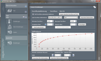

mps - a new generation of flow sensors
Since years we offer a lot of monitoring equipment for water cooled systems and the “high flow” sensor is one of our bestsellers. With the feedback and wishes from our customers we have developed a new generation with some important key features in mind: it should be smaller, offer an USB and aquabus interface, should be powered through them and everything with a low flow resistance but with an increased accuracy.
Say hello to the new mps – multi purpose sensor. The mps flow series are technically based on a differential pressure measurement and do not contain any rotating components. This method is known from large sensors in an industrial environment, they also cost a fortune and nobody would use something like that for a PC water cooling - until now ;-)
The case is made from Delrin and has an engraved stainless steel cover. The pressure sensor itself is a silicon chip covered by a stainless steel diaphragm. The sensor has a very high resolution of 0.00005 bar. Inside the case we also have another sensor to measure the water temperature. A second temperature sensor can be connected externally. Another connector generates a configurable tacho signal.

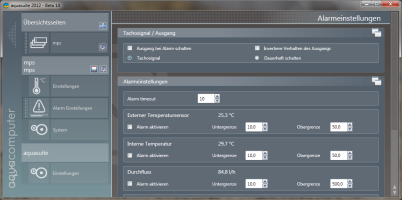

The sensor can be used by USB with the aquasuite 2012 or by aquabus with the aquaero 5. You can attach up to four of these sensors to an aquaero 5.
While the older sensors use an calibration value (impulses per liter), this one uses a calibration curve. Curves for the most common cooling liquids are already integrated in the software but you can also generate your own curve by adding at least three points with a reference value. The rest is calculated by the software.
The sensor comes in three different versions: mps flow 100, 200 and 400. The number indicates the maximum measurable flow rate. The minimum flow rate is a fifth of the maximum value. For example: the version 100 can be used in a range between 20 to 100 l/h.
The price is 49.90 EUR (41.93 EUR w/o VAT).

You can also extend the top with a tube and then place the membrane. That has no effect on the fill level detection.
The alarm outputs just generate a tacho signal like a fan. There is no need to connect them anywhere - especially not when you use the aquabus since this already provides all sensor data so you can set your alarm actions in the aquaero.
