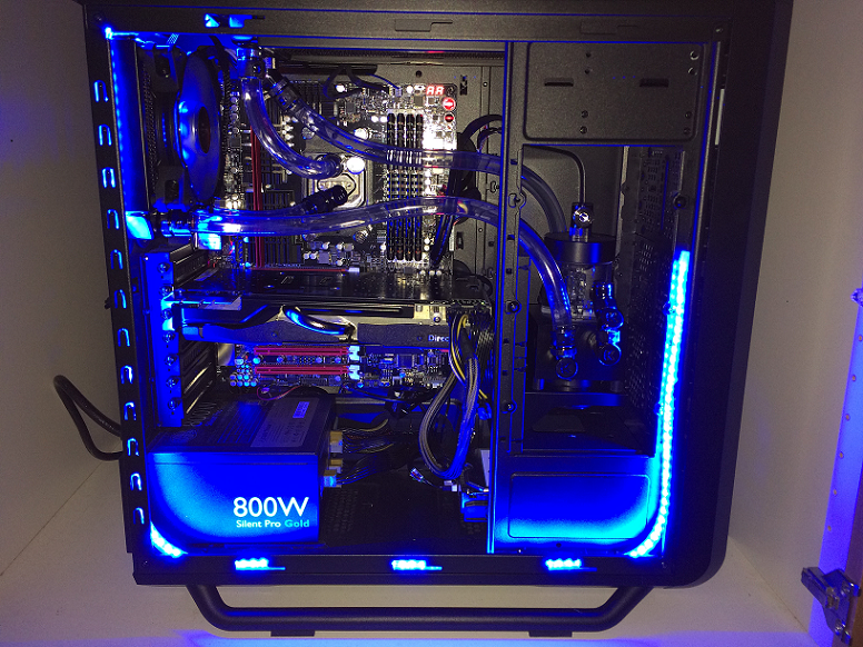

ok.. so.. my new Phanteks Enthoo case showed up today.. now, just waiting for my splitters to show up ( i only ordered them on the 3rd ) and then i'll start transfering my gear and going way overboard on my watercooling :D
time to put this... into my new phanteks..
