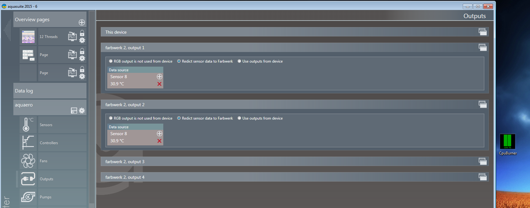

following suggestions i got a 4pin aquabus cable and y splitter and now i can view the farbwerk listed in the ''outputs'',i can also use sensors from the aquasuite,however i see no way now to change the led settings to change
how is this done now?
edit
i set it according to below pic but the farbwerk still uses the farbwek sensow,i also set it in farbwerk to aqubus external and no luck
https://forum.aquacomputer.de/index.php?…il=1&embedded=1

its hooked high aqubus
led curve is set in the farbwerk
trigger sensor is set
external source,aquarus ect is selected in farbwerk
then in outputs when i switch to direct sensor to farbwerk,the colors turn off,no reaction to temp

mardi 29 décembre 2015, 00:28
railgun
I have both usb and high aquabus connected
i went in the farbwerk and set up my led curve
i then changed the farbwerk 3rd up aquabus/bluetooth
i then went to aquasuite and set sensor 8 in the aquasuite as the trigger and checked output to farbwerk
as soon as i click the output to farbwerk,the leds go out and no load change
let me know if more info is needed

Railgun
mardi 29 décembre 2015, 11:15
This is the issue you're having...
You're telling the farbwerk to be controlled by an external device
Your telling that external device to send data to the farbwerk
You're essentially doing this... >-< ...that's not going to work.
Once you tell the farbwerk to be controlled externally, your LED controller within the Aquaero will have what you need. I think you're trying to have the farbwerk do what the aquaero can do.
However, I do see an issue where I don't see the sensor that you redirect show up in the farbwerk. Maybe this isn't an issue, but I would think if the option were there...

barfly
mardi 29 décembre 2015, 17:54
railgun,makes sense but im sure iv'e tried every possibility,ill check again later
so once i change the farbwerk to be controlled by an external device i should be able to make changes to the led curve in the a6?,,as i dont see in my a6 what you've shown in your pic.

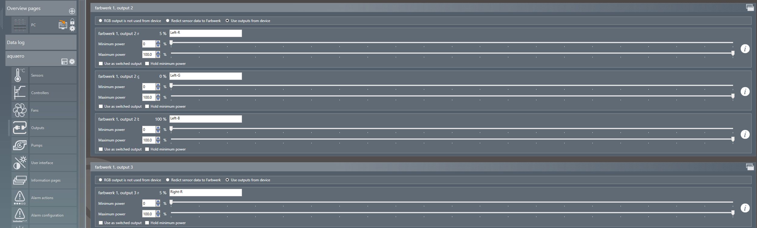

Railgun
mardi 29 décembre 2015, 20:01
Make sure you select Use outputs from this device
Then, back in the LED section for the controllers, when you add them off the right side, they should be there. In my case, I named them Right, Left, etc, simply to tell me what's what. Then you control them in a similar fashion as you would within the farbwerk itself. The only issue is fast moving color changes are not smooth. I've mentioned this in a previous thread some time ago. Else, for what you're probably doing, it's fine.
barfly
mercredi 30 décembre 2015, 00:34
ive spent countless hours on the farbwerk,much more than the a5/a6 together but going by your post
i was up and running within 10 minutes!!
its amazing how the simplest thing can be so confusing
Railgun thank you for all your help,its most appreciated.

Railgun
jeudi 31 décembre 2015, 16:50
What version are you using? Because...
Top is the controller for the farbwerk, bottom is the built in LED...
