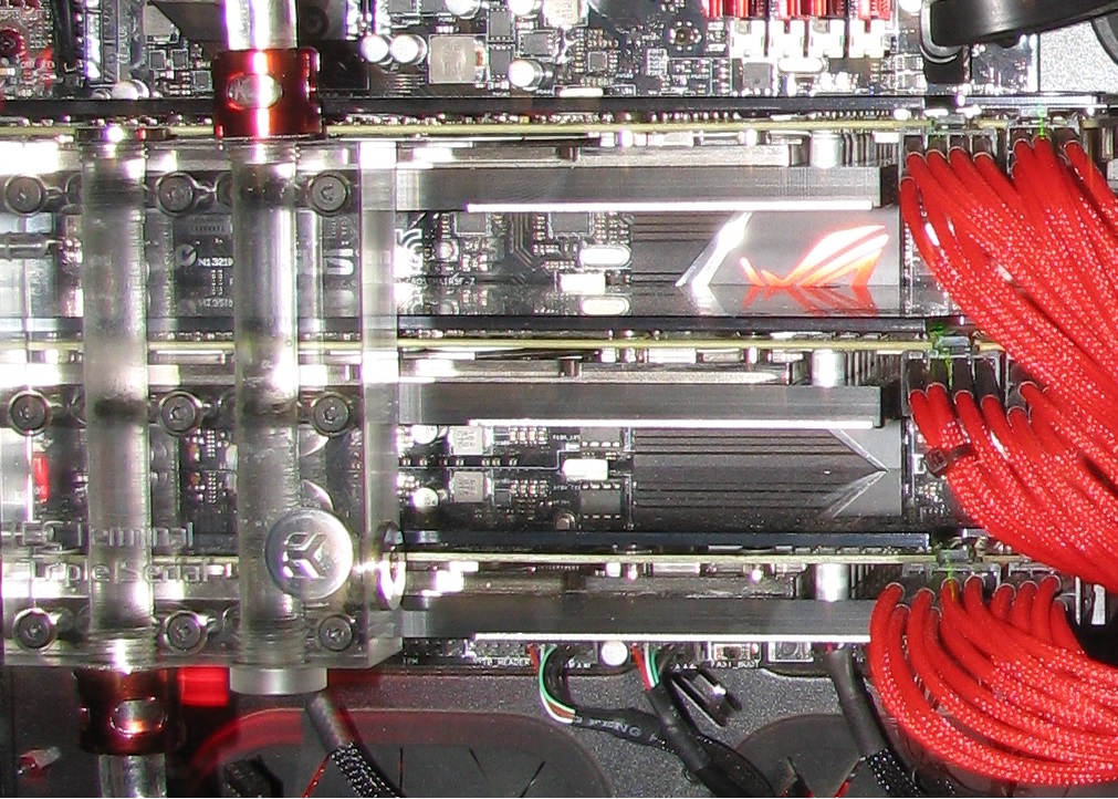

I did what you are talking about with a different product, it works great, and I'd prefer parallel flow over serial as serial can build pressure and parallel you get the same temp water cooling your gpus. Here's my shoddy workmanship, but it works and you can't hardly notice the bad job from a distance :)
»t1nm4n« hat folgende Datei angehängt:
  • 3gpu.jpg (375,96 kB - 283 mal heruntergeladen - zuletzt: 27. September 2026, 15:55)
Actually its the complete opposite. Serial has less pressure build up and temps are closer between the GPUs while parallel is the complete opposite.
t1nm4n
Dienstag, 29. November 2016, 10:47
I'd look that up again, parallel will decrease flow and pressure to each card, as pressure and flow rate are sorta intertwined here. I do have to disagree with you, but it's also a moot point as there are too many factors that can affect total system performance and temps of components, but I'll stick with my original opinion that he should just go parallel as it will keep the flow in the preferred direction for both cards and even though it does split the flow rate between the cards it's negligible anyways as they don't require the same flow rate a cpu block does.
