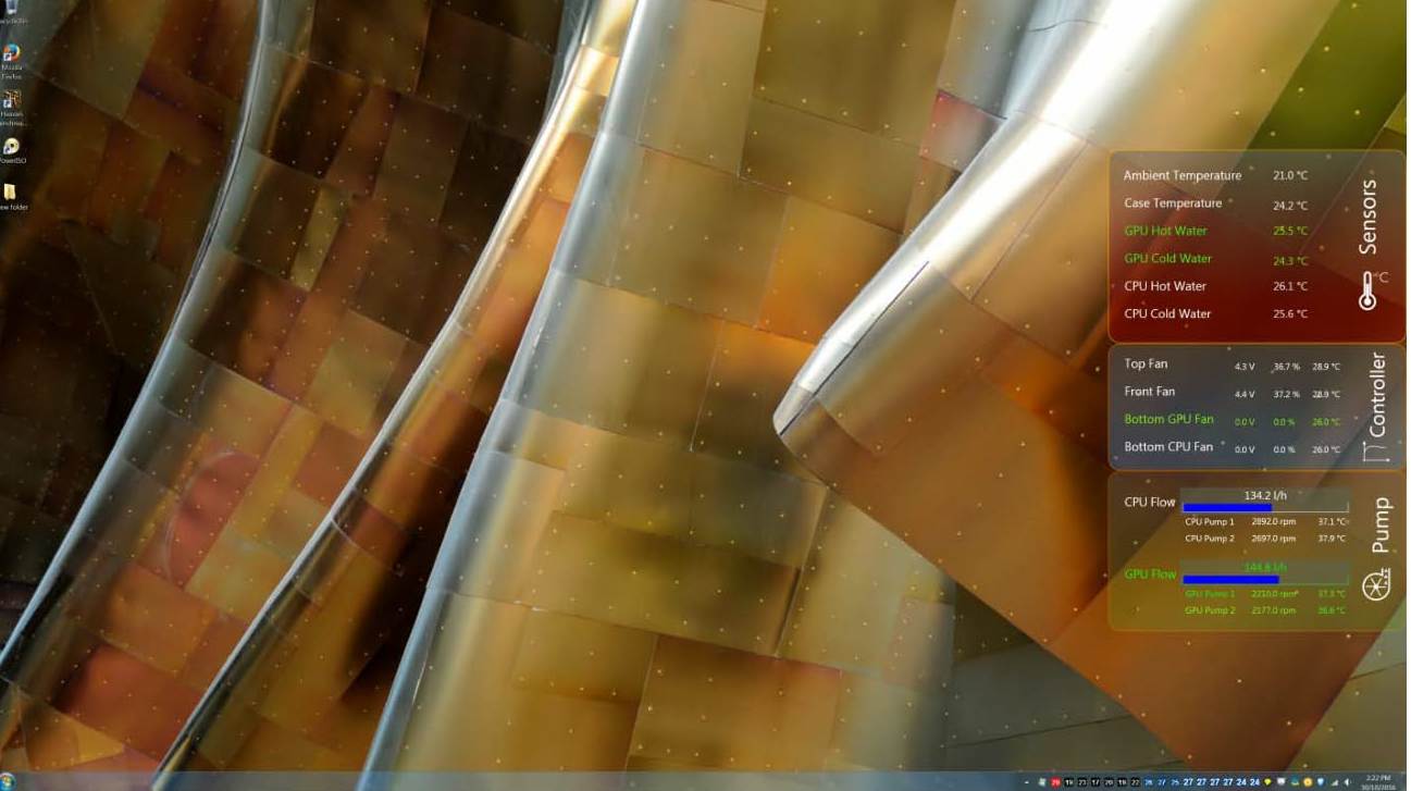

After updating with new (fixed) 2017-1.1 still missing items on page
Its all good now
