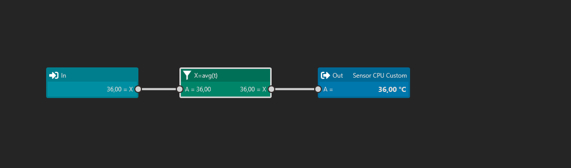

I just got a Quadro today and I've installed aquasuite to control my fans and AIO
I have an arctic liquid freezer Aio and all seems good but :
  • how to set up some alarms if needed?
  • how to set up fan hysteresis ? :) it's kinda annoying to have the fan speed changing all the time... I
    Edit : for hysteresis is it the right way to do it? I set up a virtuel software sensor with aveeage @ 5 sec
Thanks !
»Asryan« hat folgendes Bild angehängt:
Dieser Beitrag wurde bereits 9 mal editiert, zuletzt von »Asryan« (28. August 2020, 23:09)

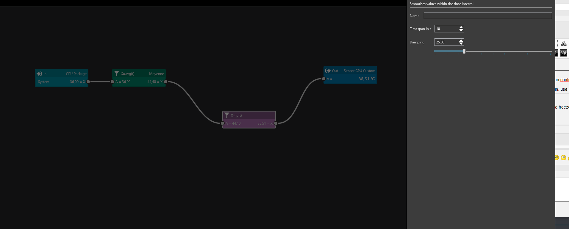

You're on the right way.
But first of all, you selected bad source for fan control, CPU temp can have spikes and is bad as a data source for fans/pumps/etc.
You'd better rely on water temperature.
At least, to have CPU temp output more plain, use both Average(t) with more then 5 secs and Low pass filter.
Asryan
Montag, 31. August 2020, 12:54
I don't have the water temps with my Arctic Liquid freezer, i can"t use it.
How does low pass filter work?
Dieser Beitrag wurde bereits 2 mal editiert, zuletzt von »Asryan« (31. August 2020, 12:57)
Well, there is a description inside this Playground element, it is seen on your screenshot.
"Smoothes values within the time interval"

Montag, 31. August 2020, 20:02
what is damping?
when the value is higher, changes from the input are higher damped

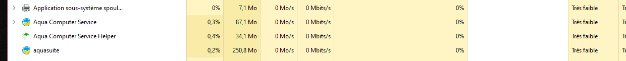

Also are all those services needed to run? thanks

"Good values" is to select another source from CPU core temp to control your fans. Use water temp.
Though, you increase Time interval and Damping inside Low pass filter, and output will be more filtered.

k2viper
Mittwoch, 2. September 2020, 09:02
Better increase time interval.
Even if you cant use water temp, there is a plenty other system temps that are not so spiky as CPU core temps.
Motherboard VRM for example, is also a good source reflecting system load. Stop thinking CPU core is your only source.
