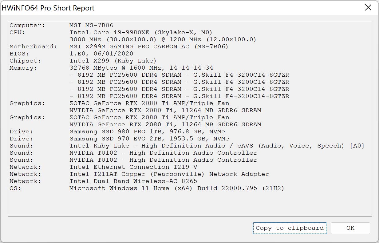

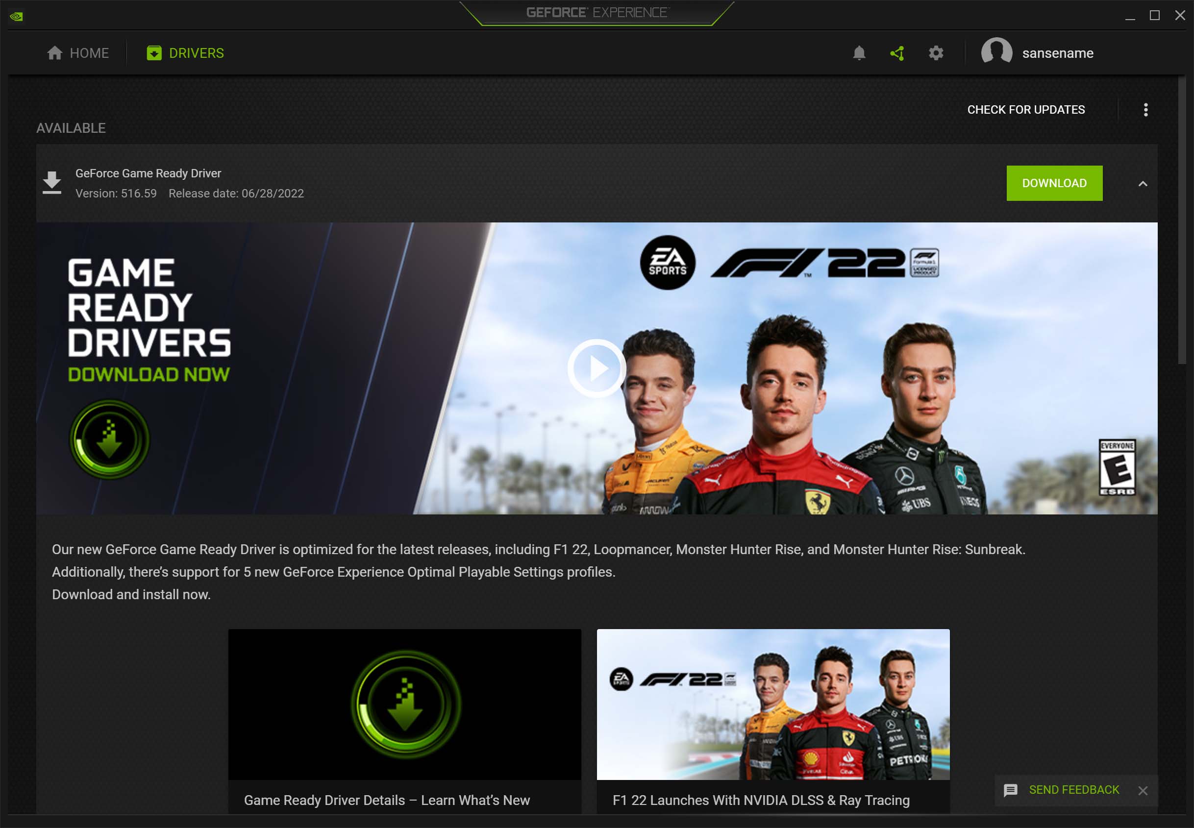

I did use GeForce Experience to update the drivers. I did select "clean install", which I know is not the same as using DDU to delete the old drivers first. So far, I have not had any problems updating video drivers through GeForce Experience.
Are you by chance using the AMBIENTpx effect to have video drive LEDs? Also, your 3rd screen shot lists a bunch of files. Maybe looking at these would tell you something.
