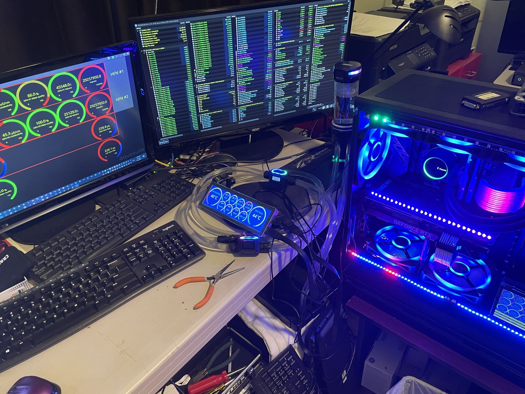

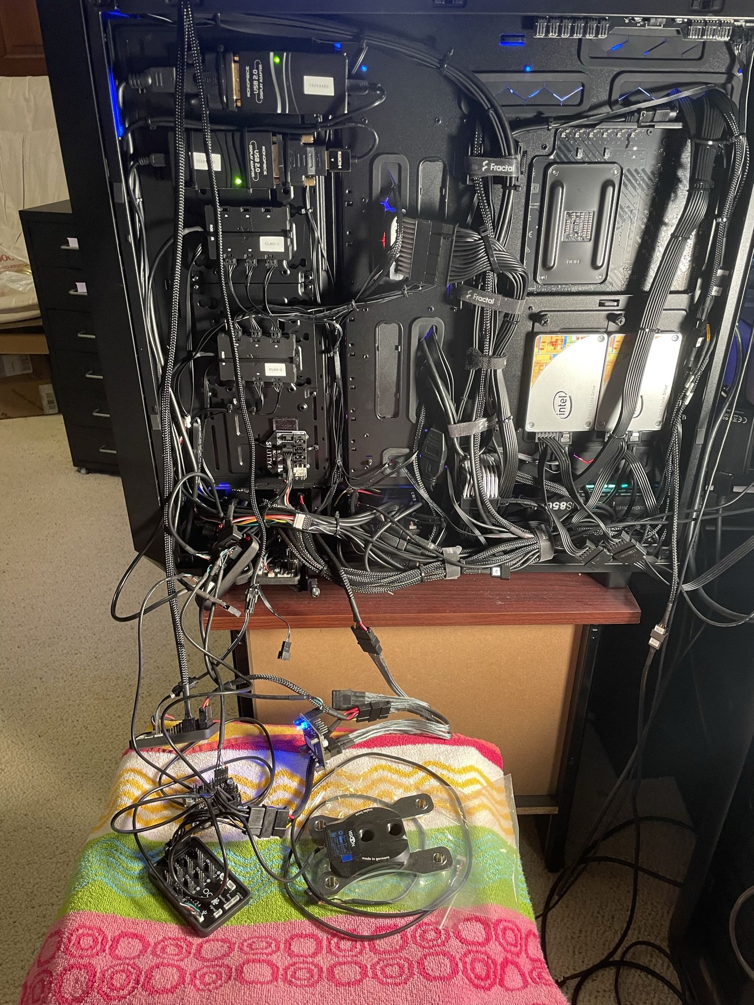

Well since you showed your backside, I will show mine.
My “test loop” is still sitting on a table with a bunch of cables running into the back of the case. My CPU is still on an AIO and my GPU still had the factory cooler on it. My real job schedule is insane these days and we are in the middle of massive house repairs so I don’t have much time to work on the loop. I built the loop on a table so I could test everything but months later it’s still sitting there. When I tear the machine apart to install all the loop hardware, I will relocate some of the controllers and redo the wiring.
My Fractal case has 2 sliding drive bays under the PSU shroud behind the PSU. I thought it would be a good idea to mount my Octo, 2 Farbwerks, Hubby7, and NZXT internal USB hubs on the slide-out drive trays. Power comes in from the back of the drive bays while all the other cables exit to the case rear. I tried to make service loops in the cable harnesses so I could slide the trays out when I need to get to those devices. It worked well but eventually, the cable harnesses got so big that it became difficult to slide a tray forward. I am rethinking this whole thing.
Some of the controllers on the "overflow table" are just connected to test them. When FrozenCPU had their going-out-of-business sale and marked their entire inventory down 90%, I bought 2 PowerAdjust 3’s for $5 each. They usually cost about $40 but Frozen’s regular price was $20 and with the discount, they were $5. I could not resist, even though I have no immediate use for them. I also have an Octo hooked up for fan testing, and a second Hubby7. The CPU block is connected for Vision testing and helping the author of SIV to add support for the Vision display (which he has now done).
