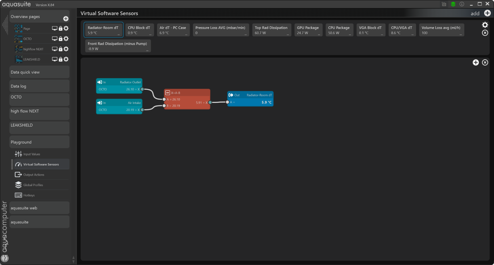

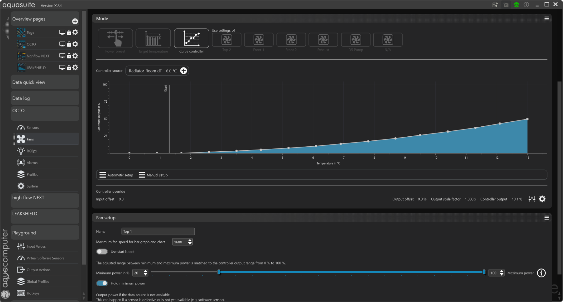

[attach]11261[/attach]
[attach]11262[/attach]
Yes it can. i don't own one but i believe it can have up to 4 virtual sensors managed onboard
Donnerstag, 1. Januar 2026, 04:11
I don’t own one either, but I think Remayz is right. Section 11.2 in the manual explains how the 4 virtual temp sensors can be assigned 3 temp data sources, and have 3 “modes” or functions - calculate the highest/lowest temp, the avg temp, or the temp difference between 2 data sources. I think you select the mode for each virtual temp sensor in Aquasuite or via the touch panel. This is separate from software temp sensors for which the data is brought into the Aquaero via USB.

That's a good call. I haven't read it past section 7.1 which didn't mention other functions than just min/max/avg.
I'm
just going out on a limb here, but I'd be curious how clever is that
part of the firmware. Could a Virtual Sensor take the output from
another Virtual Sensor as an input? Currently in Aquasuite I have 3
thermistor readings on the GPU/CPU inlets and outlet to measure the heat
each component adds to the water, and having the Octo to do PID control
and adjust the pump speed to keep to a target temperature (difference)
of 1C of either the GPU or CPU block, whichever is higher.
This would
look like a stack of Virtual Sensors, where there're two Virtual
Sensors calculating the difference on the GPU and CPU inlet/outlet
separately, then a third Virtual Sensor would take these two and feed
the higher of the two into the output. It could be done with 3 Virtual
Sensors IF the firmware can reuse their output as input between them.
This is just an elaborated pump control I have in Windows Aquasuite.
Then I could still have the 4th one to calculate a differential between room temp and the water for the fan control.

For most single loop systems (CPU > GPU > Radiator), your hottest coolant will be at the 'in' side of the radiator.
Generally, ramping the pump up and down has little effect on the cooling plate. The increased coolant flow across the plate is offset by less time in the radiator.
120 to 220 lph is normally acceptable (find quietest pump setting in that range).
Then take the delta of ambient and the 'out' port of the radiator for the fan control, and leave the pumps alone.

Could a Virtual Sensor take the output from another Virtual Sensor as an input? ...This is just an elaborated pump control I have in Windows Aquasuite.
When you set this up in Aquasuite, did you perform testing to determine what, if any, improvement it provides? You may want to reconsider what you use the calculation output data for. Unlike pump speed, radiator fan speeds do have a significant effect on coolant temp, which in turn has an effect on CPU and GPU coldplate temps. This is why many people use Aquasuite to subtract ambient temp from coolant temp and assign the delta-T data to a fan speed curve or PID controller.
Whether virtual sensor outputs can be temperature inputs to another virtual sensor is an interesting question, but unfortunately, I do not know the answer. Manual Section 11.2 says, “Mode and up to three data sources (temperature sensors) can be selected for each of the four virtual temperature sensors.” I think this means each of the 4 virtual sensors can have different temp sensors assigned to them, but it does not say whether one or more of these temp sensors can be the output of one of the other virtual sensors. Maybe someone who owns an Aquaero or an Aquacomputer rep will chime in here.

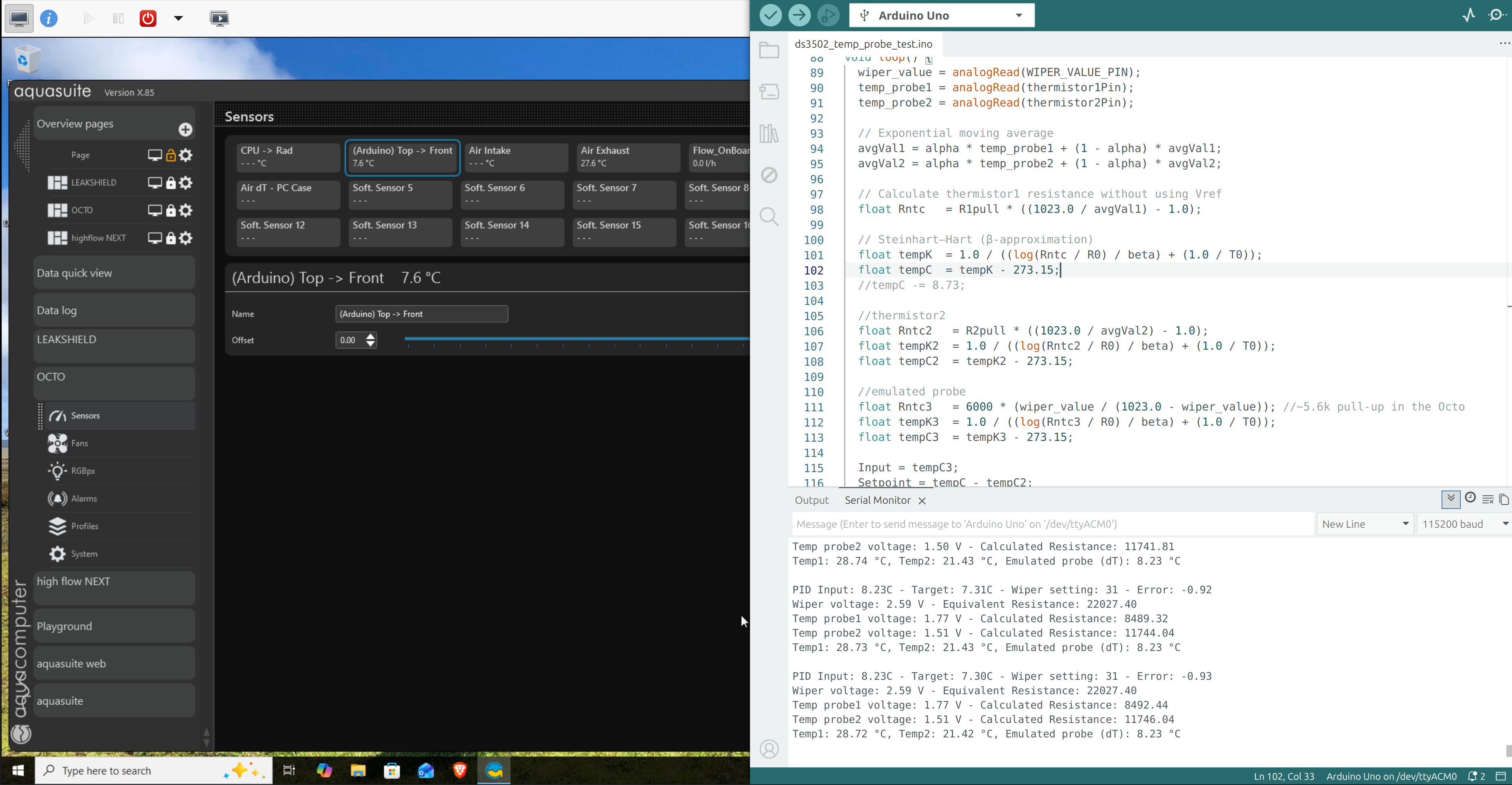

Oh, I just got an idea.
Perhaps I should make a separate board with sensor inputs and outputs, that would do the mixing itself and just feed the output to the Octo.
This would be a nice Sunday afternoon Arduino project for baked-in fix functionalities.
From then on the customizability and adjustability would all depend on how far the maker is willing to take the project on the coding side of things.
(Aquacomputer this is your chance to take notes for your next product before I patent it.)
This is a cool idea! You could set up a microcontroller and a few temp sensors as a stand-alone device and write code that will perform the mathematical functions you want on the temp sensors’ data. I would use Arduino-IDE, ESP-IDF, or STM CUBE-IDE, since all of these compile source code into native machine code and flash it as firmware stored in non-volatile memory on the microcontroller. This part is relatively easy. The tricky part is getting the final delta-T value into the Octo and not via USB. The Octo temperature sensor inputs are designed for a 10KΩ NTC thermistor. Internally, I think the Octo provides a known excitation voltage (probably 3.3 V) and includes a fixed precision resistor that forms a voltage divider with the external thermistor. The voltage at the divider junction is measured by an ADC input on the Octo’s microcontroller. From this measured voltage, the known excitation voltage, and internal resistor value, the firmware calculates the effective resistance of the connected thermistor. The calculated resistance is then converted into a temperature value in degrees Celsius using an assumed thermistor model, likely implemented as a Beta-based approximation, commonly B3950Kor an equivalent lookup table derived from a 10 KΩ NTC thermistor characteristic curve. I doubt that the Octo is using Steinhart & Hartcoefficients to calculate the temperature as these are used for levels of precision that are higher than what the Octo targets.
Your microcontroller would have to output the delta-T data in a format that emulates the resistance of a 10KΩ NTC thermistor when it is measuring a temperature. I think the way to do this is add a Digi-Pot that the microcontroller talks to over I2C or SPI. The microcontroller would tell the Digi-Pot what DC resistance to output on its analog pins that are connected to an Octo temp sensor input. For this application, I would go with I2C and a Digi-Pot like the Analog Devices AD5241. It may require a series fixed resistor depending on the range of the Digi-Pot. If you have an idea for an easier way to get the temperature value from your microcontroller into the Octo, please share. Maybe I am overcomplicating this.

Eh, hell no! My D5 goes down to 1% PWM at idle. And up to 30% at full load. 30% is my noise limit. My noise threshold is 2%. :)
So 1% gives me about 50 l/h, and 30% is around 120 l/h. There IS a huge performance difference on the cold plate between these two. If there wasn't, then the PID control simply wouldn't ramp up as the thermal delta between the inlet and outlet wouldn't run away. There may be not much diff ABOVE 120 l/h. But below it it's day and night.
Plus it's not the CPU temp that matters, as that will stabilize exactly at throttling temps: 95C on my Ryzen. It's not CPU or water temp where you'll see the difference. It's in the boost clocks. :)

Yeah, I thought about that part. There are multiple ways to go about it. If you are willing to hack the Octo, then you could feed a voltage straight into its ADC, bypassing its own voltage divider.
If hacking isn't an option, then presenting a simulated resistance is also not that difficult. There are ways to do it, the simplest being a simple digipot and the more sophisticated being an active programmable-impedance circuit. Well, either way the material expense of the project would be just the fraction of what an Aquaero costs... I really don't see a reason why would we reserve such a simple functionality only to the flagship product, when it's all in the code, not in the hardware (well, if the Octo's ROM had a few KB legroom left in it, but we won't get to know that). An Octo could do the Virtual Sensor thing just the same. :S

Yeah, I thought about that part. There are multiple ways to go about it. If you are willing to hack the Octo, then you could feed a voltage straight into its ADC, bypassing its own voltage divider. If hacking isn't an option, then presenting a simulated resistance is also not that difficult. There are ways to do it, the simplest being a simple digipot and the more sophisticated being an active programmable-impedance circuit.
I had not considered hacking the Octo. Sending a voltage straight to its ADC should work. For the other option (into an Octo temp sensor header), because it's just emulating a thermistor, an active programmable impedance circuit could be a simple MOSFET controlled from an ADC pin or a filtered PWM output of the microcontroller. I think a Photo-FET Optocoupler would also work. For a digi-pot, Adafruit #4286 is an Analog Devices DS3502 I2C-controlled digital 10K potentiometer on a small breakout board with a Stemma QT connector.

If you do attempt to hack the Octo or spoof a 10K NTC Thermistor, please post your results. I think there would be a lot of interest from Linux users and people who want a fully hardware based control system that does not rely on Windows software and USB communication. Heck - you could probably make it a product and sell them on TINDIE
Teasuti
Dienstag, 20. Januar 2026, 11:25

In the meantime I found the time and motivation to dust off my old Arduino Starter kit and experiment with an NTC and the DS3502. I was more interested to see the DS1841 in action, but that unit I got was a dud... :thumbdown:
Well, at least I learnt enough of the Octo's sensor input to say it has got a simple voltage divider on the ADC, and the 2-pin connectors are the GND and the ADC input with a 5.6k pull-up resistor on it.
Sadly I did not have that exact value in my shoe box of components. I'll have to put it on order, just to copy the Octo as closely as possible.
The Uno was connected to the usb port of the PC, so the common ground is also sorted through the usb connection.
As for the digipot, I connected it to the Octo in several configurations and found that in pure rheostat mode it only serves as a 0-10k variable resistor. That with the 5.6k pull-up gave me a very narrow window of 25-30C. The starting point of 25C matches the expectations of the Steinhart–Hart approximation, but the high end has fallen way short of expectations.
Oddly enough the temperature reading in Aquasuite wasn't consistent. Over the course of a minute or so it was sort of "wandering" up and down +-1 degree, which I don't understand why. On paper the resistor ladder is electronically separated from the chip's control circuit, so the Uno's 5V logic and Vcc, plus any sort of noise or Vdrop should not affect the sampling on the voltage divider in the Octo.
Now in a different configuration - after identifying the pin-out of the Octo - if I use a 3v3 reference on the high terminal of the potentiometer and use it as an actual potentiometer (GND on the low terminal and of course the wiper is on the ADC input), I could effectively bypass the pull-up and achieve the full range from -15C to around 40. I expected it to show well above 100C as well when the resistance gets in the low two digit Ohm (zero on the ladder, but the wiper itself also has some resistance). It didn't go much higher though, which I also fail to understand. No matter though, for the intended purpose of dT functions, I'd hardly need a range bigger than like 0-15C.
And I didn't observe much variance in potentiometer mode, when the voltage is fed into the ADC directly via the digipot. I guess the pull-up resistor along with the external 3v3 reference could bias it a little, but the consistency is much better for some reason than in rheostat mode.
If an electrical engineer reads this and have a better idea what's going in with that +-1C uncertainty in the temp readings, please let me know. It also could be the works of the firmware in the Octo, as it seems to smooth out the reading. Some sort of post-processing is going on it there too.
My next step is to get some pull-up resistors and start to toy with a couple NTCs to implement the functions I want, then try to feed the result into the Octo.

I made some progress today on the Arduino side of things.
So I have a working prototype now.
I hooked up the board to the Octo, stole two sensors, calculated a quick delta T, then fed it back to the Octo via the DS3502.
As imprecise as it is with the large steps (I get in potentiometer mode - RH, RW, RL all connected), the concept works like a charm.
Next phase will be to design a breakout board for the chosen digital potentiometer and experiment with that in place of the DS3502.
See what kind of precision do I get. If the 10-bit ADC is anything to go by, with the Steinhart-Hart formula I get temperature readings with a two digit precision. If I can reproduce that on the Octo with a 10-bit digipot, I'll be happy.
