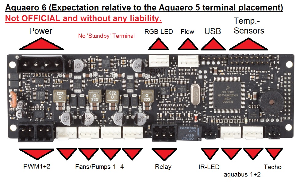

I've looked at this page and it seems to be mentionning only 4 fan outputs, but I see 8 on the pictures you've shown us. Is it an error ?
Jakusonfire
Samstag, 14. September 2013, 02:35
The four x 4 pin fan headers grouped together on the bottom left as you look at the back of the device are the fan headers. The other 4 pin headers are Aquabus ports, and LED PWM power outputs. Edit: Sorry RGB and IR LED ports.

Pilo
Samstag, 14. September 2013, 10:10
This is only an expactation of the terminal placement of the aquaero 6, can be wrong in some areas.
Samstag, 14. September 2013, 11:23
The image has wrong desriptions for some headers!
mandrix
Montag, 16. September 2013, 12:47
So, is there no +5V SB header? (I can't see one)
If not, why?
Thanks
Pilo
Montag, 16. September 2013, 14:32
Perhaps the USB headers of modern motherboards provide enough stable +5V standby power by now, that the old-fashioned 'aquaero power connect - 24 pin ATX standby power / ATX break' isn't needed any more.
