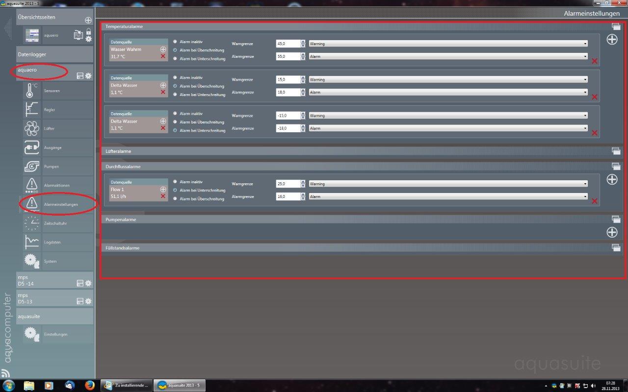

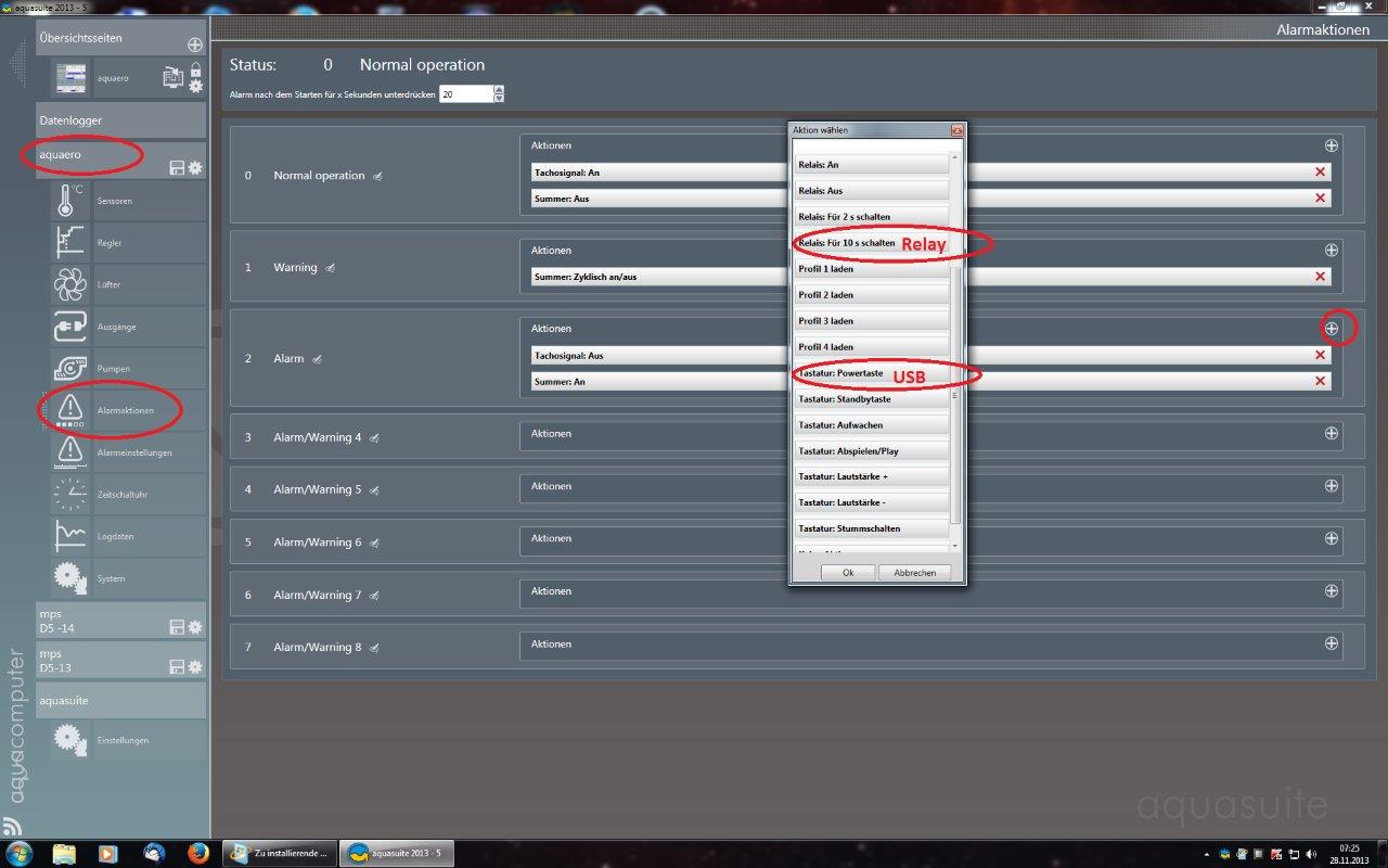

ok, now i have these things coming which one do i need to turn off my computer with the remote control on the 5xt and what one do i need to have my computer turn off if there is no flow of water or the pump stops working.thanks 2 allAqua Computer Plug 3pin Plug For Relay Output (For Aquaero 5),
Aquacomputer Aquaero Connector 2pol. For Relay Output ,
Aquacomputer Aquaero Power connect - 24pin ATX Standby power / ATX Break
You are wrong, read it over again.
To turn off with the remote control you only need USB-connection.
The other stuff you can do with USB-connection only, too.
Or you hock up the Relay Pilo´s way.
»EnigmaG« hat folgende Bilder angehängt:

ok,EnigmaG how do i use the remote to shut it off and on .i do have usb hooked up on the aqua5 but at the moment my flow meter don't want to work so have to take it apart and see,for the turning computer off when there is no flow or pump stops working right?
do u have english in them pictures u posted..lol
Freitag, 29. November 2013, 08:39
Contents 18 and 21 in The Manual
