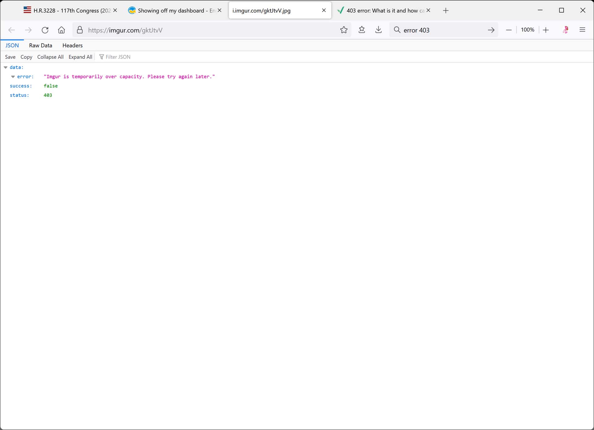

Like my dashboard , minimally on the LH secondary monitor lol
I hate that imgur does not allow access while using a VPN (403.jpg)
What does an error code 403 mean?
The 403 error, also called 403 forbidden error, or HTTP 403 error code, is issued by a server if a client (browser) lacks the required access rights. Access is “forbidden” and the message “Error 403 – Forbidden” appears in the browser window.
Dieser Beitrag wurde bereits 1 mal editiert, zuletzt von »InfoSeeker« (30. Juli 2022, 13:23)

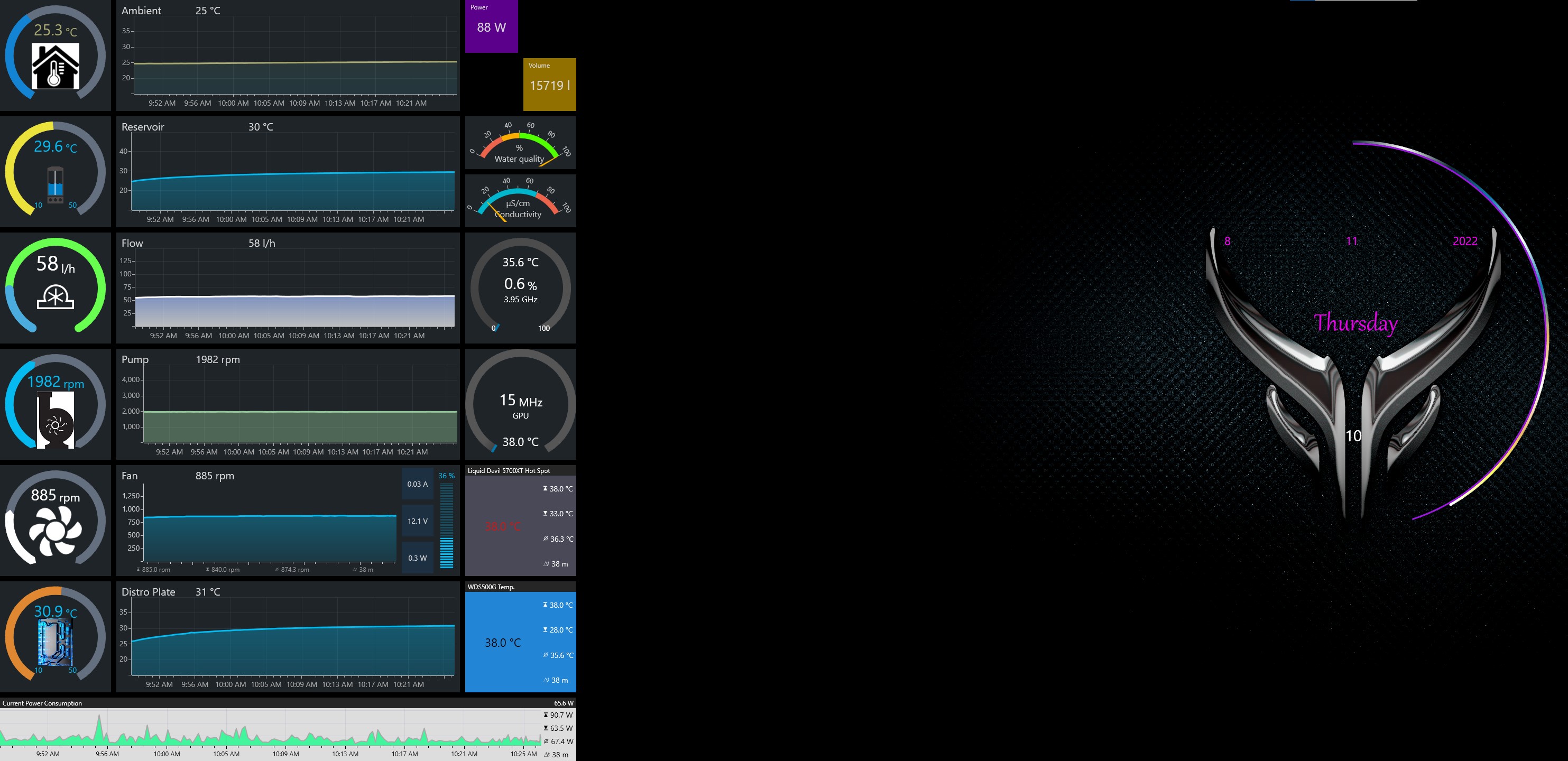

Updated desktop
Donnerstag, 11. August 2022, 19:29
I have made some changes to my dashboard/desktop. The clock is now centered on my desktop background over the Liquid Devil logo. The outer ring is a 24 hr clock and the inner ring is 60 minute "hand". The pump and fan icon "animate" but I don't want to install Radeon Relive only to capture desktop video. The distroplate is the Phanteks 120 one which is the actual one I have in the rear of the P600s. Hopefully I can get the reservoir icon to animate about the y-axis so that we can see water movement.
»aquaman2030« hat folgende Datei angehängt:
  • desktop.jpg (585,71 kB - 183 mal heruntergeladen - zuletzt: 10. Oktober 2026, 16:28)
RE: Updated desktop
Freitag, 12. August 2022, 01:52
Impressive. This looks like something that can be done in an AIDA sensor panel but I don't know how you are doing some of these things in Aquasuite.
May I ask how you got the time of day into the Overview page? Also, how did you get the day of the week to say "Thursday"? When I select data source Time - Day of Week, I just get a number. I suspect this can be changed by editing the XAML code, depending on how the data binding is done.
I started a thread about adding time of day HERE. Turns out it requires writing custom XAML code which some of the more experienced forum members kindly submitted several attempts. Sebastian (Aquacomputer Rep) posted that date and time will be added in the XAML presets in the next release of Aquasuite for those of us who don't know how to write the code.
I am also wondering how you got those different icons in there, let alone animating them. I tried adding an XAML block and loading the Animation with Data Binding XAML preset. I set the date source to a fan RPM. I get an animated fan that spins but its quite "jerky" in its rotation. The animation does not speed up and slow down with fan speed but it will stop spinning if the fan stops spinning, so it does at least indicate that the fan RPM is greater than zero. It's also a dull gray color, not nice and white like your fan. I don't know how to bring in an icon or an image file. Are you doing all of this with custom XAML code?
For capturing a quick video of a window, I used OBS Studio which was pretty easy to figure out.
aquaman2030
RE: RE: Updated desktop
Freitag, 12. August 2022, 23:12
I shall try to be as concise and answer as much as I can. This is the code block that I use for mapping the integer values to day name:

Those icons are simply png files. Some came with aquasuite under ..aquasuite\Content\images, depending on where you installed yours. Others I grabbed from the world wide web. I also noticed that the fan icon was spinning funny initially. Then it dawned on me that it's simply a square image so I looked into the XAML code and adjust the x-y axis so that it's centered. For example, a 200x200 png, its center would be x=100 and y=100.
Here's the code for the white fan (that image came with aquasuite):

WinstonWoof
Sonntag, 21. August 2022, 00:22
revised my desktop view
Ok Graphs only update every 2-5 minutes (its a feature of the logging system) but thats not the end of the world for me. I have a few key figures that are real time.
Am displaying the last 24 hours(or will be) , the gaps are when the PC is off
