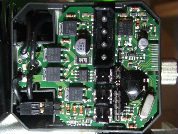

Remove the yellow cover at the back from your pump. Use a slotted screwdriver, insert it one after another into the leads for the base-plate and turn it a little bit. Aftwerwards you can easily remove it.
Take a look at the lower right. There you will see a 2-pin connector for the internal temperature sensor. Above you will see a small diode, above this you will see a pair of diodes. This pair of diodes should have a yellow ring. If one of them has a black/brown ring it has been damaged due to an overvoltage or short circuit. This normally only happens when the USB cable was plugged in the wrong way.

That's a good tip ... I will have a look in a few minutes (better switch of the PC first)
Just found out my mobo does not have a parallel port ... so I can't use the flash cable.
I'll check the diode now and will ask for support if it is broken ... (perhaps spare parts can be ordered).
I presume this must be the case as I probably did wrongly wire the USB in at least one occasion.
It would explain why there is no communication whatsoever, but I'll let you know in a few minutes.
OK. I've had a look (and took a picture, see attachment).
The pair of diodes that you've mentioned both seem to show a yellow band.
I guess now all I need to do is find another PC (with Parrellel I/O port)
drag it nearby this PC and try to connect it with the pump to flash it.

Controller dead as a doornail
Donnerstag, 12. März 2009, 00:32
Sorry for the double post, but I have an update on my situation ...
I dragged the 2nd PC in my thouse from the livingroom to the attick, where my watercooled PC is located.
The 2nd PC has a LPT1 gate at the rear (unlike my own motherboard) and enough empty internal USB connectors.
But when searching for the pump with the flash-software ... No pump is found on any channel. Also the USB is (again) not detected at all (and this is NO Asus mobo)
So I can only conclude that the communication with the controller of my pump is completely dead.
I probably killed it when the usb was wrongly connected at one of the first attempts to connect the pump to the mobo.
The pump seems to work autonomeous though, so I still have cooling, but no controll.
Does anyone (Shoggy ?) know if it is possible to order a replacement electronics part ?
(I looks like it would need only a very limited amount of soldering)
In that case I may not need to 'bleed' the liquid out of the system, which would be the case if I have to replace the entire pump.

My new (replacement) controller board finally arrived today.
After installation to the pump there was good news and bad news.
The good news is that the USB now immediately was detected by windows, and Aquasuite also found the pump.
The bad news is that this new controller shows a continuous red LED and the pump is not running.
(also reported by the aquasuite)
I double-checked the pump-wire connections, but they were correctly placed and making good contact.
So unfortunately, I will have to RMA it (already filled in the form) and wait for ANOTHER replacement.
I replaced the controller board again with the original one, and now my pump works again (but without USB).
I do not seem to have much luck with my pump ...

Ask them to physically check the board before they ship you another one. Was your replacement a re-worked unit?
PvHooijdonk
Mittwoch, 25. März 2009, 09:31
I think it was a brand new one.
I am sure I connected the two pump-wires correctly as well as the molex and the USB-plug.
From the first moment I applied power the red-LED kept on burning, and did not extinguish (as happens normally with my original board when starting up the pump). The pump did make some very faint noises though, but it would not run.
I hope they can/wil replace it.
At least I know now that it CAN work, as have seen the USB work on the new board and the pump works with the old board.
Now it would be nice if this could be combined ...
<<<UPDATE>>>
Today I received my replacement controller board. And guess what ... Everything works !! Hurah !
Now I finally can enjoy all the cool stuff !!
