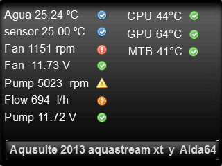

Soy despistado error mío falta de atención.
Después de revisar minuciosamente el código. El problema era que yo no escribía el comando de llamada para la imagen correcta mente.
{logdata.LogdataSets.CpuFanSpeed.} incorrecto
{logdata.LogdataSets.CpuFanSpeed.Level.Code} correcto
Ya está solucionado. Puedo mostrar los iconos en todas las opciones de aquastream xt
Muchas gracias

I will put a simple design to show to you
:thumbsup: :thumbsup: :thumbsup: :thumbsup:
novax1
Sunday, April 14th 2013, 8:53am
Only one design. Test
above shows all the icons for aquastream xt.
thank you very much :thumbsup:

Here's my datamap files and G19 layout for those that want to see how its put together..
I added temp bars to CPU cores, GPUs and water and edited some icons and imagemap files. I now get orange indicators for when pumps, fans or flowrate are at maximum, and triangle warning when low or exclamation alert when below minimum. Temp alerts are the opposite going from low to exclamation alert.
I run my datamap files and XML from the C: root directory.
The eos-19 Layout from the layout folder using my eos-aquasuite layout.
PS. you need to create the sensor xml export files in Aquasuite using the same file names as my datamap file names without the .datamap;
For example gpu-rad1-fan5-speed.datamap.txt you put gpu-rad1-fan5-speed as the filename in Aquasuite XML export for the fan sensor. The other XML export files you need to name the same way.
To use my layout you'll also need Aida64 and MSI afterburner, otherwise you'll need to remap those sensors to whatever tools your using.
