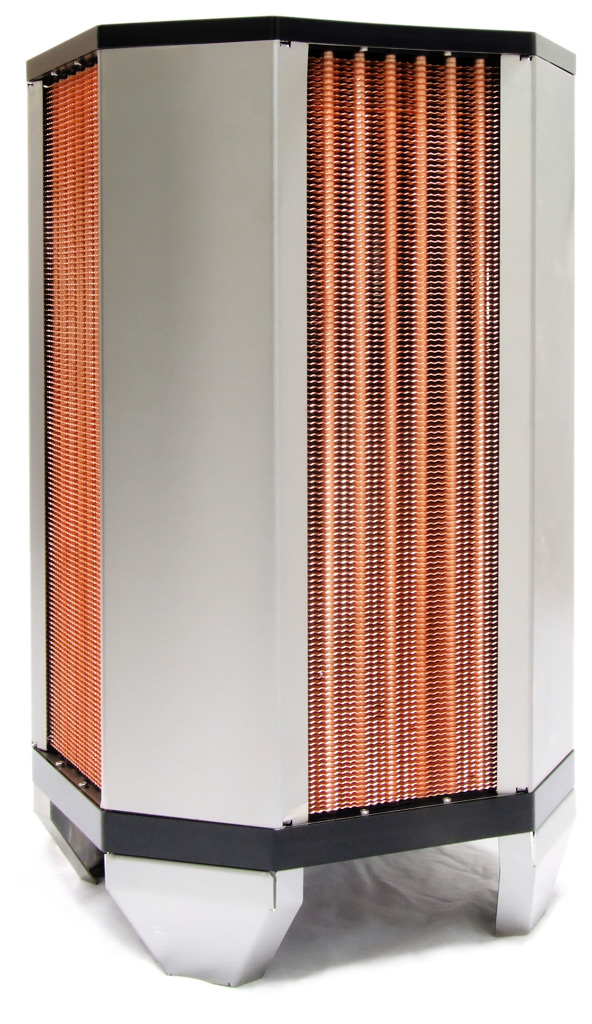

my rad 360mm * 360mm and about 50mm thick is supposed to be good for 200W passive
it looks from the photos that each of the 4 sides of the gigan is of a similar radiator core design, but huge ~ 900mm high by ~200mm wide, but not sure of thickness, I guess 25mm.
So i would imagine you would be looking at least 500 - 600W passive

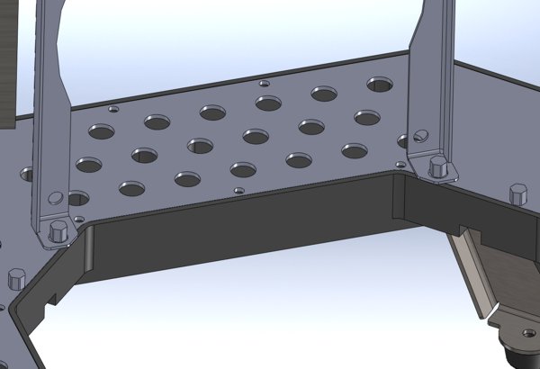

I too am considering purchasing a Gigant 3360, however, there's not much info on the shop.aquacomputer.de site as far as info on how to mount the pumps / reservoir / fans brackets.
Someone from Aquacomputer really needs to create some support docs on this product & it's accessories & add some more pictures for the mounting mechanisms and g1/4 locations.

Thanks Pilo for the pics & links, that really does help to clear up some confusion I had about the mounting and plumbing holes positions for the GIgant.

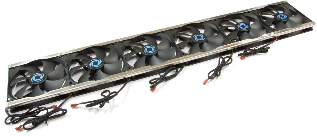

If the single / dual fan top & bottom won't work, then I'll probably have to go w/ the fan rails and use a bunch of 140mm fans (6 on each side) x 4 sides = 24 fans (that's a lot of fans)!.
Also from the pics, it looks like you can mount an Aquero directly onto the radiator. How is that done? I don't see how there would be enough clearance for the Aquero PCB and the copper piping. Also screw holes don't appear to be present for such an installation.

Wow 24 fans is a lot of fans, perhaps you will not need so many. Given the fan mount channels are probably going to be the cheapest items on your order, buying a few and adding fans as required after testing is probably your option as so little information is available about 180mm fans top and bottom. But I have to wonder, given the Gigant appears to be designed for passive cooling, by the time you start adding lots of fans ( air pressure) perhaps the shorter Gigant (perhaps all copper) is an option or the extraordinary Airplex modularity system ( although Mo-RA3 has sweeter mounting options)???

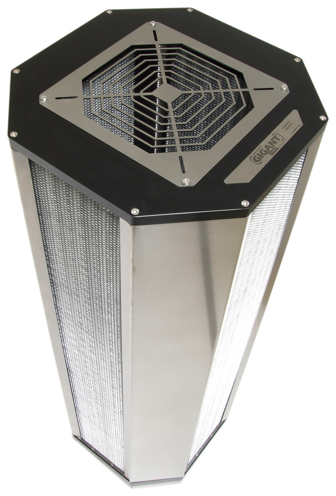

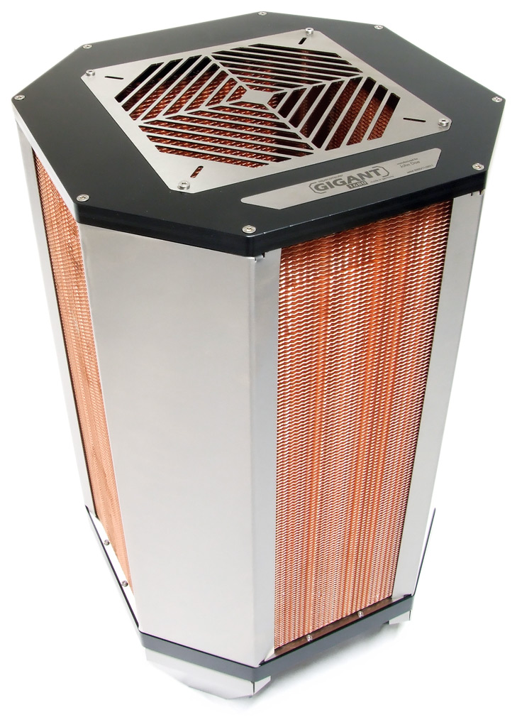

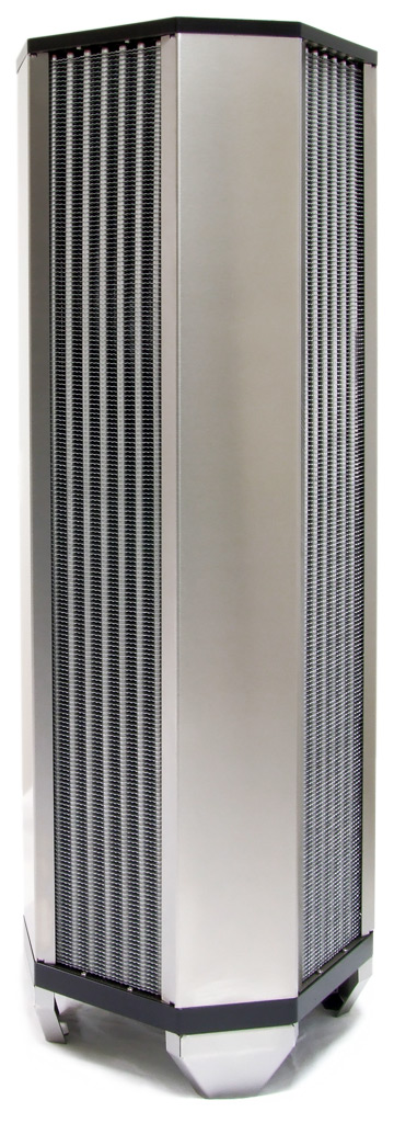

Both the 1680 and the 3360 are available with either copper fins or aluminum fins... the tubing is copper in all cases.
airplex GIGANT 1680, aluminum fins
airplex GIGANT 1680, copper fins
airplex GIGANT 3360, aluminum fins
airplex GIGANT 3360, copper fins

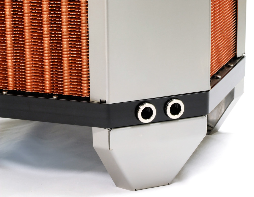

Anyone know what the black connector below the USB port is for?
This post has been edited 4 times, last edit by "InfoSeeker" (Aug 9th 2014, 5:52pm)
Rostiger
Sunday, August 10th 2014, 9:11am
HI,
i think this is the 12Volt DC - Powerconnektor .
Sunday, August 10th 2014, 3:37pm
Indeed, that could well be.
The lack of documentation makes planning a system very difficult... if that is the 12V supply, is there a tap out for an internal pump?
Does the connector and cable provide for the fan speed signal output to the MoBo as does the Aquaduct?
Is there a PCI bracket for connectors as has the Aquaduct?
How many circuits does the radiator have (for pump planning)
Guess I will keep searching the internet, but so far not one single build log or review of anything Gigant.
