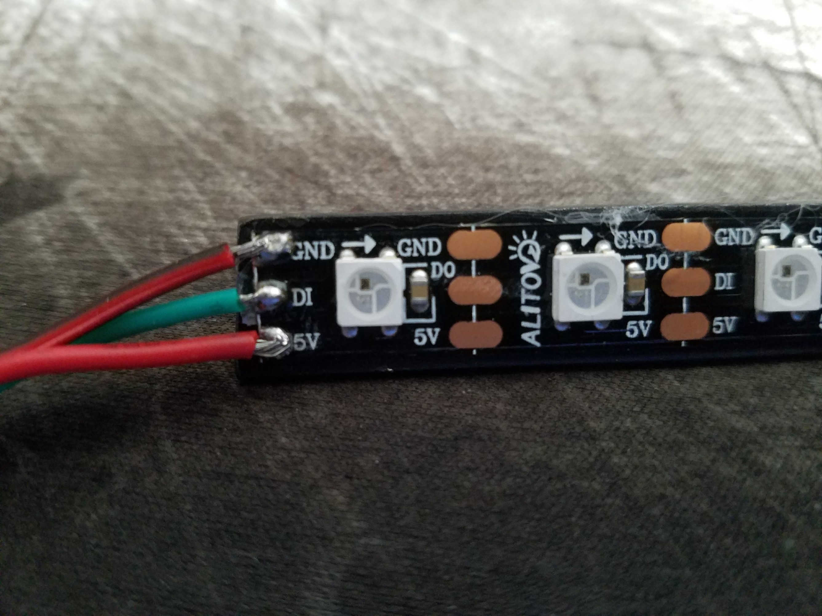

Hello,
I recently replaced my Corsair Commander Pro with your QUADRO unit. have some WS2818B 5 volt Addressable RGB light that I controlled with the Commander Pro.
Is there a wiring diagram for the RGBpx cable?
attached is a picture of the LEDs I am using.
»noryss« hat folgende Datei angehängt:
noryss
Sonntag, 23. September 2018, 08:16
Found the Solution:
RGB works perfectly using an extension harness that I cut and probe with my DVOM. Soldered some new male and female connectors and it works like a champ! hope this helps someone.

Samstag, 12. November 2022, 19:12
32 cm strip have all 4 pins from the connector soldered onto it.
27,3cm strip however (just like the WS2812B) are a 3 pin strip. Where could be the 4th pin be soldered to, and for what reason? There's nothing on it except 5v, data and ground leads. Especially when @noryss got it to work by not using the mysterious white wire from his RGBpx connector or he just forgot to mention about it which I doubt he has done.
I don't have the 27,3cm strip so I can't check it myself, though for me it looks like it might be a 4 pin RGBpx aka PicoBlade connector on it, used only for compatibility reasons, however 1 pin is unused since it's a 3 pin strip or it maybe doesn't even exist. Let's found out and solve this puzzle. I've just ordered 5m 300 led WS2812B strip for my 32 inch monitor (140-150 LED splitted on 2 channels & 6 strips).
I gonna check the white wire on my 32cm strips connected to Farbwerk 360 when I'm done with rebuilding my system by simply pulling out the white wire and see what will happen. Gimme one week or so.

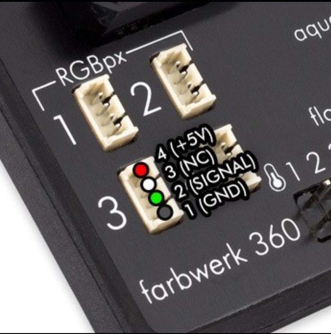

RGBpx Pinout and the 4th Wire
Sonntag, 13. November 2022, 18:35
I think the 4th conductor on 4-pin ARGB connectors is data out. Corsair uses this in conjunction with their RGB hub to daisy chain the LEDs in one strip or fan to the next. The 4 conductors are +5VDC, Ground, Data In, and Data Out. RGBpx pin 3 (white wire) is not connected to anything because AC does not route the Data Out back through the connector and cable like Corsair does. Here is a picture of a Farbwerk360 that shows what is on each pin.

don_dolarson
Freitag, 2. Dezember 2022, 13:43
Hi and sorry for delay. I needed to order some connectors as well however below is the result.
https://youtu.be/WFTsLIfoW9o
As you can see on the clip, the green wire going from Farbwerk 360 is in the end not connected at all. There is a conflict in wire colors between the 50cm cable going from Farbwerk 360 and the 50cm extension cable, they simply doesn't match anymore and is "upside down" - black became red, red became black, green became white and white turned to be green. It's how these parts just been shipped to me and I guess they haven't been assembled correctly at the factory. It's just cosmetics and something to remember when connecting LED strips, otherwise a short circuit will occur.
