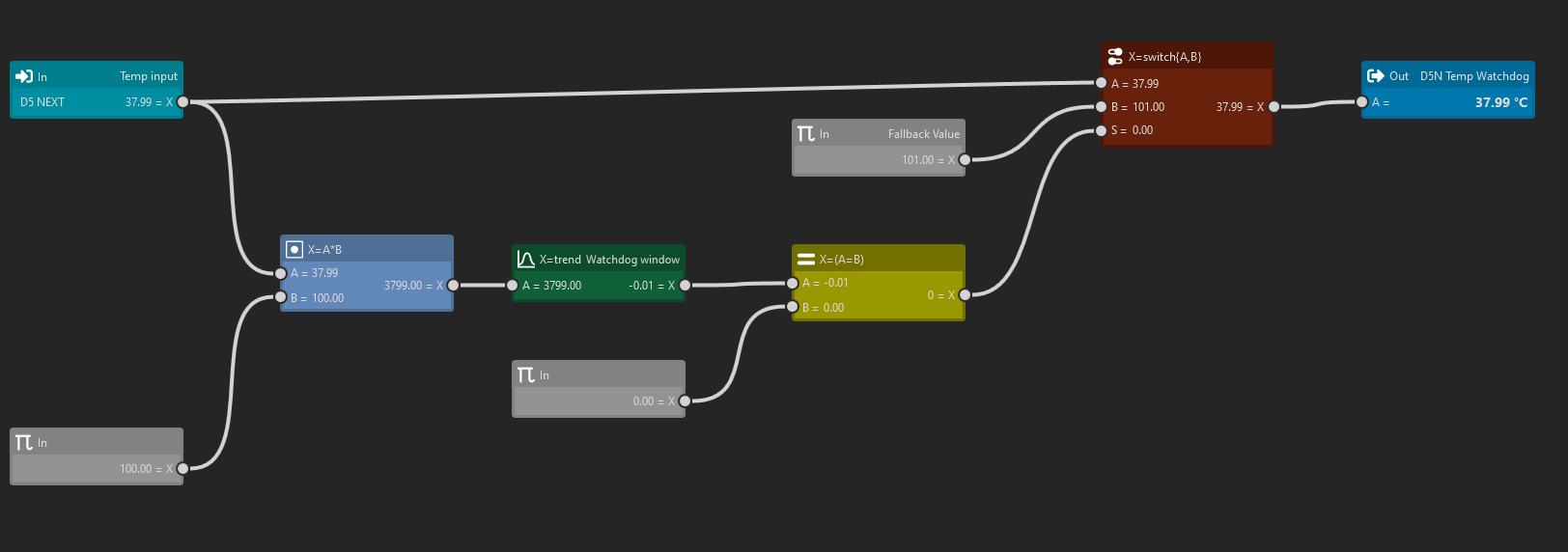

I was thinking that one way to make this a safer failure in the future would be to set a watchdog timer which would change the temp to a fallback value if the sensor value has not changed over a specified time interval, like 30 seconds. When things are operating correctly, there will always be some level of variation in temperature. What happened today was it was stuck at exactly 38.08C for several hours.
Is this watchdog something that could be performed via the Playground?

So this is a quick stab at a watchdog sensor that I think will do what you have asked for.
https://www.youtube.com/watch?v=mxoOKzBpcnA

After watching it run for a bit, I made one small change. I multiplied the D5N temp by 100 to try and increase the effective resolution of the trend function. Without the multiplier, small variations of .01C didn't seem to be registering on the trend. Adding the multiplier seems to have cleared that up.

I had initially assumed that the calculation was handled to more sig figs than on display, but then I noticed that the switch was triggering sometimes even when I saw the raw temp value moving .01C. Adding the multiplier doesn't add any precision to the temp value, but it effectively does add them to the trend calculation. The .01C changes that had been shown on the Trend function as 0 are now getting processed by the Equals function as non-zero.

[attach]9593[/attach]
I think another way that might achieve the same result is to add a delay step between the Trend and the A=B steps.
