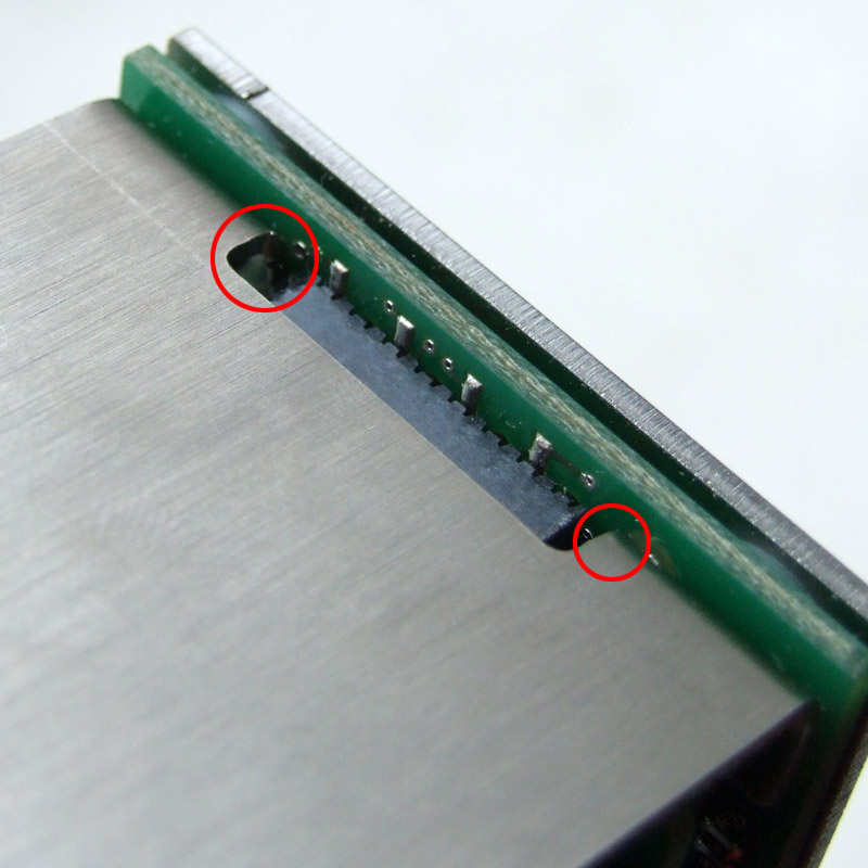

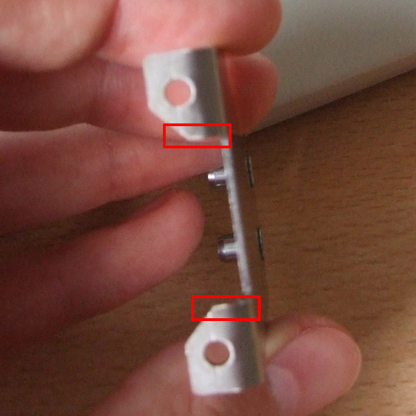

Both of you could check the following: if you look at the front cover, at the right site of the mounting panel you can see a black connector for the display and a bit of the PCB from the display. On the PCB you can see some soldering points. Make sure that they do not touch the stainless steel mounting brackets (see first photo). If you think they might touch it, remove the mounting bracket and shorten this area a bit with a rasp (see second photo).
You can also easily test it. If the problem occurs and the soldering points are the problem, it should be gone when you remove the whole mounting bracket.
@aphasia: if that does not solve your problem we are very sure that there MUST be a problem with your USB ports or the power supply. Having the same problems two times in a row is almost impossible. Please try the device with nothing attached expect for the 4-pin power plug. If the problem is gone you could connect one after another of your components to check which one is faulty. Please attach the components when the device is turned off!
@Snargaloo: when you tell me your full name and address via instant message or e-mail we can send you a new front cover which will solve the problem with the hypersensitive touch buttons.
