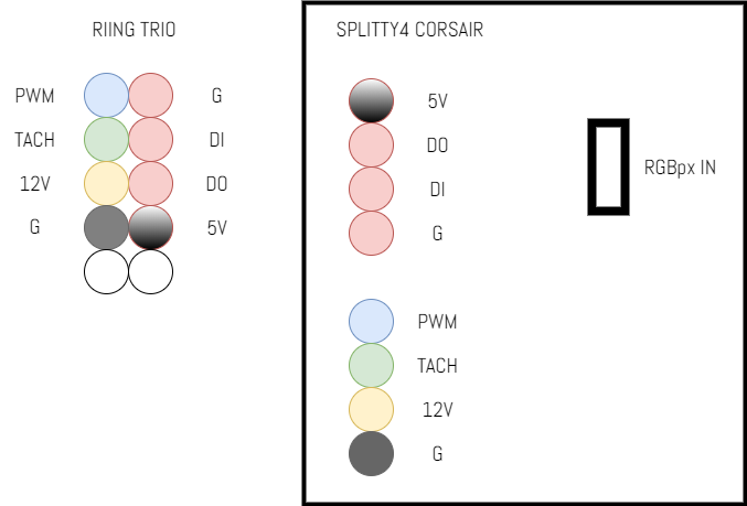

Hello there from France, i'm new to this forum and this is a pleasure to me as i'm finally finishing a project i started a while ago (with some pauses).
First, this is about a simple water loop over a dual system in a double TT X5 Core case.
I learned about AquaComputer products and determined what would interest me.
I would like to accomplish the connection of Riing Trio 14 Radiator Fans TT Premium Edition fans on the SPLITTY4.
Using watchound post as inspiration :
https://forum.aquacomputer.de/weitere-fo…gbpx-splitty-4/
• Does anyone know if the pattern is different from the TT Pure Plus concerning the 4 RGB pins ?
• If not, do you know how to find out with a multimeter ? Even an helpful link would be fine...
• Do you think there is any problem in the schema below ? (higher res as attachement)
Note : I'm not sure yet about Corsair ML120 PRO Fans, if i don't get them, i will just delete 2 SPLITTY4 and connect RGBpx on the RGBpx Quadro pin.
Thank's

EDIT : the answer was under my nose, under the sticker of the fan i can see the PCB with 5V DO DI .....

i'm actually trying to do this with the Riing Trio like you already successfully did. But i did not get my test fan to light up. If i got you right: you rewired the pins from the fan to the RGBpx / Corsair pins on the Splitty, right? I noticed the 5V and GND pins on splitty are swapped at least on rev2. So i wired everything acording to that.
While a corsair fans lights up while plugged in the splitty, the Riing fan won't.
My setup is the following:
Farbwerk360 - splitty - Riing Trio.
I only connected the RGB Part.
Can you please provide some help? I'd appreciate a lot!
Cheers topas

Hey topas, back 6 months ago i had not enough time to finalize the entire setup, so i plugged the air part and used it with no RGB. Now i'm updating this, i almost finished a full sleeving, and it brings me to the TT part..
To finish the work with the TT RGB. It did not work for me aswell 6 months ago but there is maybe a misunderstanding in the picture i took of the FAN PCB
Maybe the DO DI start at the 3rd Pin, i'm 99% sure not but im investigating today.
Where did you find this info about rev 2 please ?
Did you find a workaround ?
Dieser Beitrag wurde bereits 1 mal editiert, zuletzt von »DRF« (10. Februar 2020, 15:51)
DRF
Mittwoch, 12. Februar 2020, 18:31
Yes !!!
I got it finally working thanks god !
Here is the fruit of this work.
To anybody who wants to know, please keep in mind that this is kind of a "hack" and you must know what you are doing.
Apart from that : Enjoy !!!
»DRF« hat folgende Bilder angehängt:
»DRF« hat folgende Datei angehängt:
