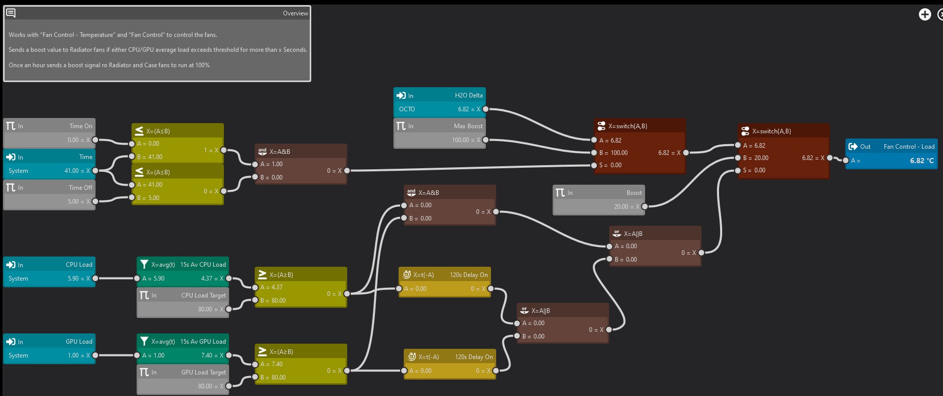

The simple way of approaching that (although it is a little cruder) is to add An Off Delay from the Functions so that once the triigger has gone from 1 to 0 it remains latched on for x seconds.
You can see how I use it at the following link

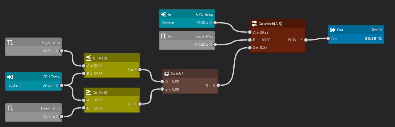

Although this I think more accurately represents what you are looking to achieve
[attach]9258[/attach]
I am trying to follow the logic in this diagram. The AND gate will output 0 until CPU Temp is >= 80°C. When CPU Temp hits 80°C, the AND gate output will go to1, the switch will go to input B and the output will go to 100 (max). OK so far. Now as CPU temp drops, as soon as it goes under 80°C the top conditional will go to 0 so the AND gate output will go to 0 and the switch will switch back to input A. I don't see how the output will stay at 100 until the CPU Temp drops to 50°C. What am I missing here?
Ok so as the temperature (A) passes the LOW figure(B) that outputs 1 as it is >=A
att his point the AND gate wont fire as only its Bis 1
As the Temp (now as B) passes the High (A) the <= outputs 1 as A is now Less than B
At this stage the AND gate outputs a 1 which switches the final switch from A to B and therefore sets the Out figure to the "Set to Max" Figure
As the temp
oh bugger that doesn't work does it lol
/me wanders off..................................

Have you taken a loook at my method that uses load & time linked to fan curves rather than siwtching on temp?
PID controller tuning
As the temp
OK so I am not crazy. I think it can be fixed by adding and OR gate between the AND gate output and the switch input. The OR gate would be controlled by a conditional on the low temp value. I was going to dig into it but now I am thinking that the Flip Flop logic construct suggested by Grestorn may work with less logic. I am just not sure that a NOR Latch is the best one. There are a bunch of variations of the Flip Flop logic construct. NOR Latch, NAND Latch, JK Latch etc. I think one of these may be the most direct way to implement this.
Update- I tested this FIXED and it seems to work. Going to play with the Flip Flop option later (supposed to be working now...) I had to increase the Low Temp constant because my 5950X is running over 50°C because its really hot in the room I am in.
Update 2 - I have confirmed what Grestron said a few posts back - AQS does not seem to allow recursive logic. I can make 2 OR gates "OR-A" and OR-B" I can connect the output of OR-A to an input of OR-B but then I cannot connect the output of OR-B to an input of OR-A. So I can't make the flip flop. WAH!
Yes, am currently triggering all fans when the PSU puts out more than 350 Watts. (psu.jpg)

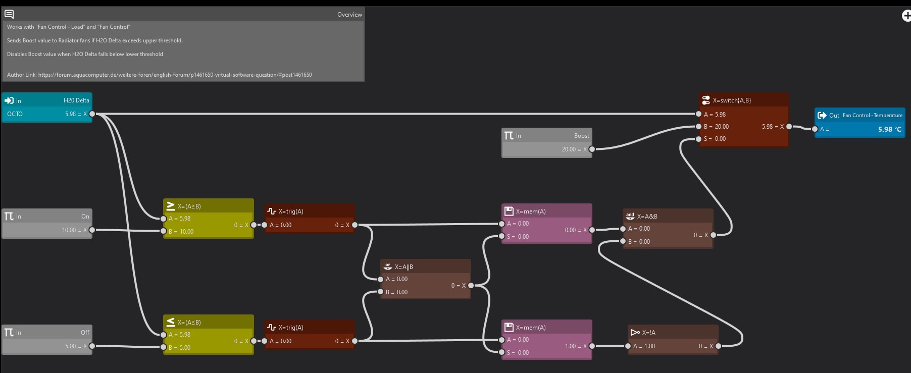

Remayz
Mittwoch, 9. März 2022, 00:42
Goddammit that pissed me off...
that flip flop was annoying to make :p
I think i got it. it's a bit convoluted but i've watched it work for the last 5 minutes :p
There's the upper and lower trigger temperature setpoints, to start and stop the fan boost.
The way it works is overriding the temperature used to control the fan speed.
If the temperature goes beyond the upper setpoint, the real sensor value is overriden by a value of your choice.
This fake temp is kept active until the real sensor temp drops below the lower boost setpoint. then normal control is restored, until the temperature goes again over the upper setpoint.
The flipflop is made through upper and lower trigger feeding an OR gate, and the output of that gate refreshes the output of two memory outputs.
Since the lower temp rigger is inverted, and with the help of the output AND gate, we get a logic output changing to 1 when the water is too hot, and to 0 when it has been cooled :p
the picture explains it better than me lol! Have a crack at it, put the sensors you use, tweak the fixed values, see how it goes :)

So rather than try & build @Speedy-VI 's work into my existing Load & Time Fan Control (which would have looked messy) I've taken the simpler approach.
Use the Load & Temperature control Virtual Sensors as inputs on a third Virtual sensor which sends the Max value from either of the first two to the fan controls.

Remayz
Mittwoch, 9. März 2022, 12:25
I tweaked it slightly to replace the upper trigger by an aquasuite input, since i have no need for the emergency function. the input injects the value 20 in the upper trigger. The reset button just resets that input to 0
When i finish gaming at night, i just click boost and reset, and the PC will cool off quickly until the water is 4° over ambient. I used to do that manually with the fan offsets, but i may remove all that part of the inputs window actually :)
