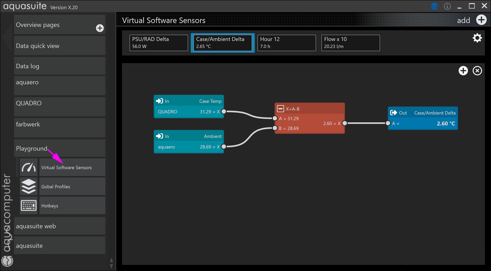

MikeM
Mittwoch, 3. Juni 2020, 03:41
Thanks, looks like USB only will be the way to go. When I first powered on the octo, I noticed it had 16 software sensors and no virtual sensors... makes perfect sense now.
I hadn't played with the virtual software sensor yet. It looks like a pretty powerful system and I was able to duplicate the aquaero's virtual sensors easy enough. It amazes me how intuitive this software is compared to alot of its peers.
Mike
