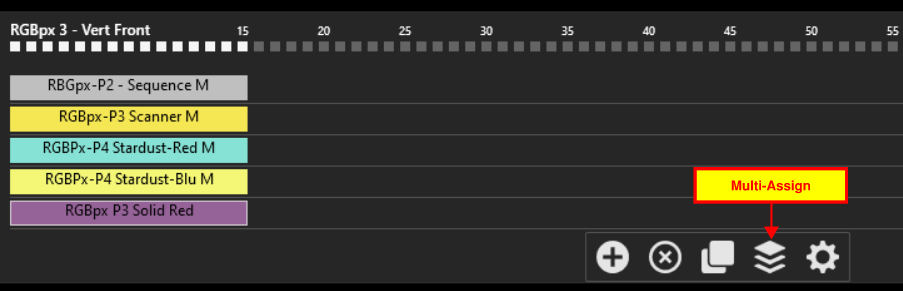

Yes its still in X.53. PICTURE
Also, Aquacomputer did mention a few months ago that they will be adding some sort of multi-device RGB sync capability. I don't know any more details than this. I am really looking forward to this because I have 2 Farkwerk360s and currently there is no way to sync them.

Yeah I think Multi-assign is limited to the Farbwerk360 and the Farbwerk Nano. The RGBpx ports on the Farbwerks also support Transparency. For the Octo, Quadro, and other devices that have RGBpx ports on them, as you stack RGB effects (they call them LED Controllers), the effects higher in the stack block the effects below them. With Transparency you can allow effects lower in the stack to "bleed through" the effects higher in the stack. This is a very powerful feature that allows an LED or group of LEDs to be driven by multiple effects at the same time. This opens up a lot of possibilities.
