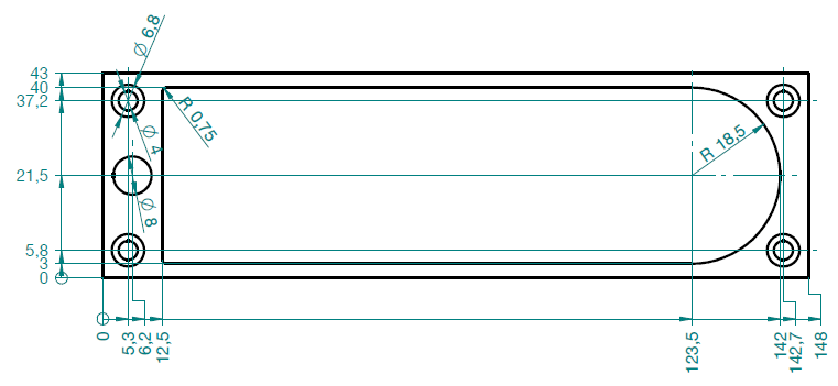

does anyone know if these dimension are accurate for the aquaero 5 xt?
»AP2« hat folgendes Bild angehängt:
Montag, 4. Juni 2012, 09:44
The general dimensions are OK but the front of the current XTs have been updated and the area of the IR diode has been slightly changed so you can not take this drawing as reference anymore.

thanks Shoggy for the confirmation. How do i know if i have the updated faceplate? Also, is there a drawing with the correct dimensions?
Dienstag, 5. Juni 2012, 09:03
I have no detailed drawing available.
The aquaeros have different order numbers. You will also find this number on the box of your aquaero. The one with the older front has the number 53089 while the newer one has the number 53125. The difference is also visible:

You can easily spot the difference on the IR diode. The older ones have a separate hole there while the current one is integrated into the main cut-out.
