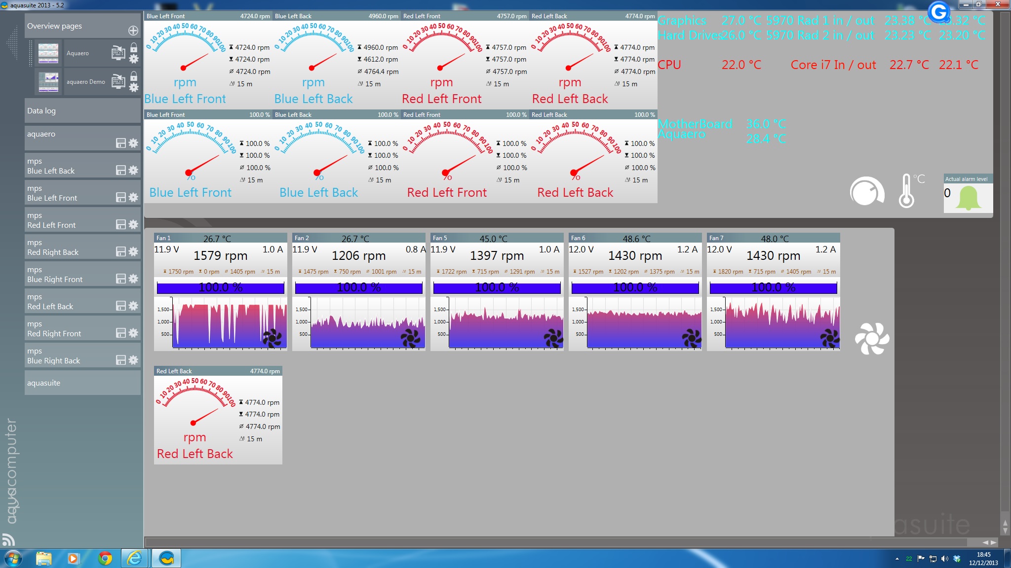

So I have connected all my fans to my aquaero and my poweradjust ultra and I'm getting strange readings from them.
They are showing unstable rpm readings.
They vary between 0 and 1752rpm on every channel and range from 0.9amp to 1.2 amp. I have a graph that shows the last 1 min and it's like a lie detector test.
There are 3 per channel and6 channels. I'm not trying to lower the speeds. They are all the same brand and model fans.

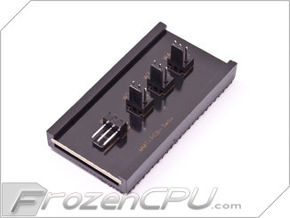

Here is the splitter I'm using.
I have 6 of these. Each has 3 fans connected.
There is one of these per channel on my 3 poweradjusts and 1 per channel on my Aquaero XT

AquaSuite ScreenShot

i actually don't know about the internals of that splitter.
but since its made for fans i have to guess that it only lets 1 fan return its speed signal.
try to switch places of which fan is on which header of the splitter. (maybe 1 fan is faulty)
if that doesnt work, just connect 2 fans and not 3 (you seem to be using a lot of power).

I think I had a similar splitter as that one once.....it has traces that connect all 3 signals from the fans to the output header. What you can do is scratch the rpm trace all the way through between the 1sr & 2nd fan so that only the first fan closest to the output header is producing an rpm signal to the output header
Like was said, only one fan in a group can report rpm or else the device has no idea what is going on.
A good thing to do is educate yourself on fan wiring and learn how it works. People that have a lot of fans in their rig usually learn how to make their own wiring harnesses. For example I have several fan harnesses I made that are connected to 8 fans. In each case the rpm wire is picked up from one fan only and sent to the fan controller.
I have seen lots of fan splitter devices that are made wrong, you have to be careful what you buy.
