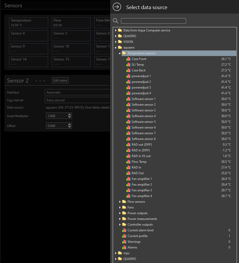

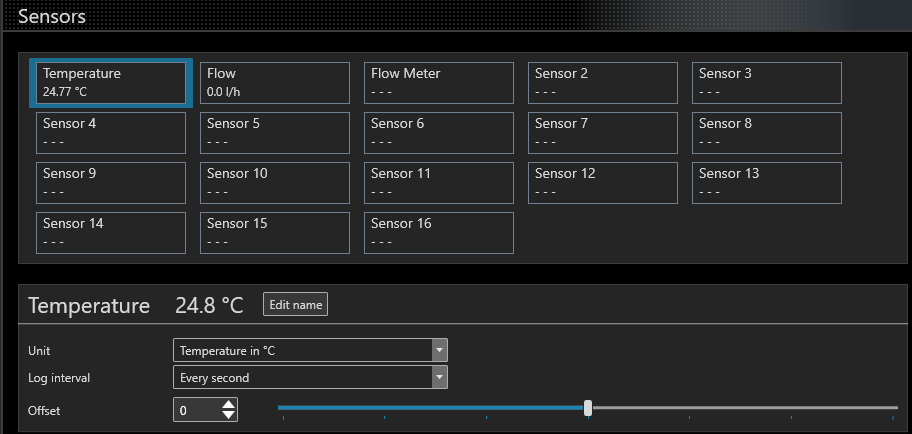

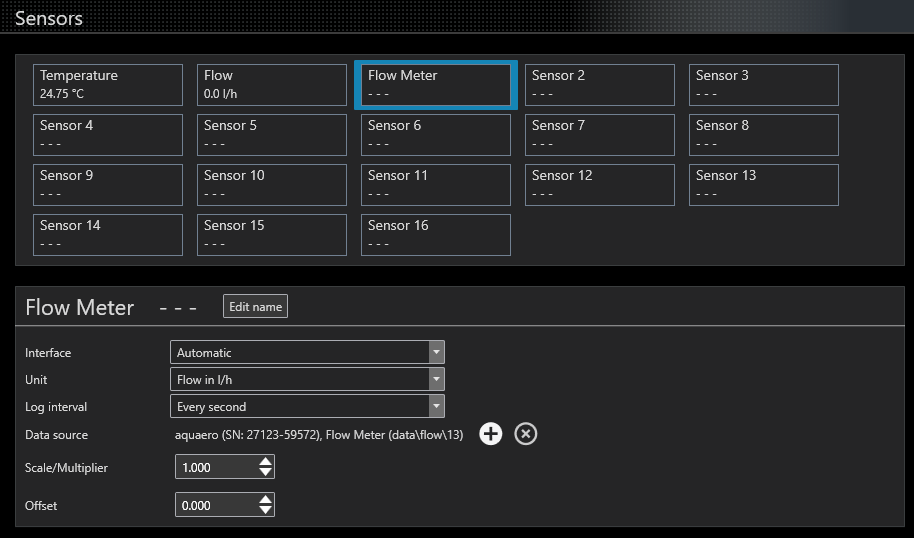

Hello, im running 2x quadro, 1x aquaero, 1x mps, 1x vision. I recently updated to x.13 from a much older version of aquasuite. Now for some reason, the vision cannot read and display any of the sensor data. either form aquabus or from USB (sensors1.PNG & sensors2.PNG). As you can see, all the sensor data is available (sensors3.PNG). I have also make sure the firmware is current across all the aquacomputer devices. I also reset the vision device to factory settings.. still no luck.

try a clean install from the aquasuite. (all settings lost) and reset every device to factory defaults.

I ended up stopping and starting the service and that fixed it.
