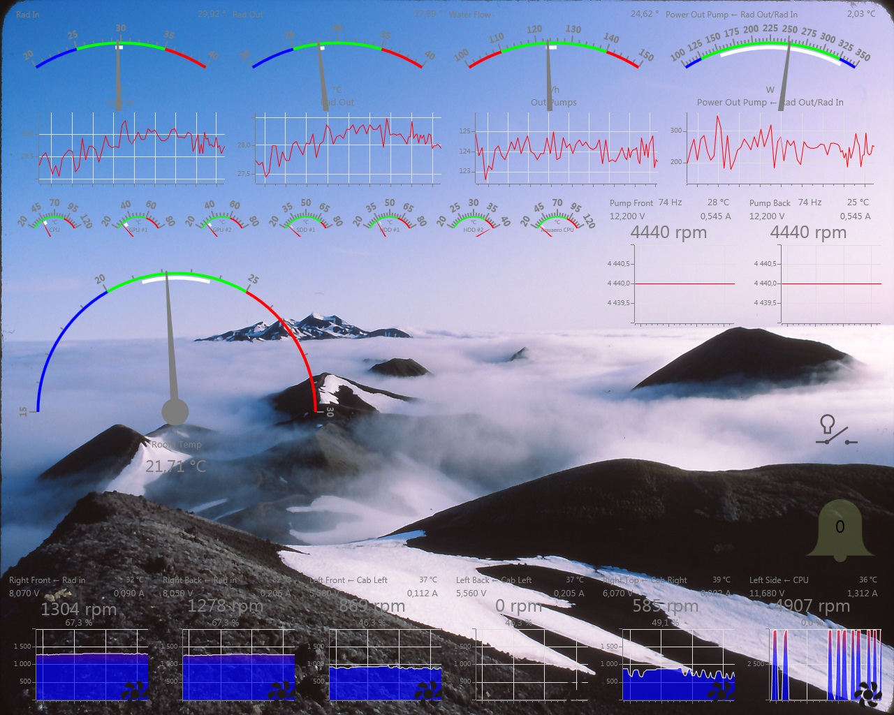

please see this image...I made this and some steps are available in my build log at overclock.net towards the end of build log.
Basically, make new page, and copy from samples provided and paste... (ctrl -c and then ctrl -v) . Once you have your layout, right click and change data source if it is not showing the value you wanted. Fan rotating is a gif and has only two states (on or off); it is not related to a data source.

"The gauge, unless choosing 180 degrees, doesn't show the whole pin, and thus looks ridiculous"
No, you just have to re-size the gauge box for the whole pin to show, I have several gauges that are set to 120 degree angle but also show the whole pin, that little red line round the edge of the gauge when you click on it, try dragging one of the red boxes in the corner of it.
