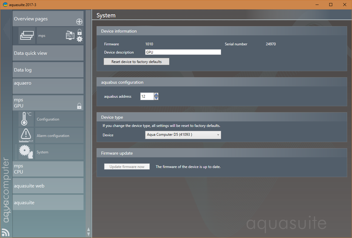

Still not working... :(
All firmware is updated (usb connection for both pumps works fine). I've tried all the following for the aquabus connection:
- Connect both pumps (using a splitter. Pump 1 on address 12, pump 2 on 13);
- Connect pump 1 with single cable
- Connect pump 2 with single cable
Using different cables, always shutting down the computer and disconnecting the PSU.
Really need help, guys! Any thoughts??
So you see the two pumps in the aquasuite tabs, but you do not see the pumps in the pumps tab under the aquaero?
A screenshot may be helpful.

Exactly! Both pumps are available as mps, but under the aquaero "Pumps" it's empty. Screenshots attached, and thanks for the reply! :)
»StephanWeber« hat folgende Bilder angehängt:
Sonntag, 5. November 2017, 08:25
are your 2 mps pumps listet as mps under aquabus tab?
Reset your 2 mps to factory defaults, switch the device type (system tab) to a other device and switch it back.
Select the bus address.
Save the settings (disk symbol).
When everything is correct you see the both pumps in the aquaero tab and see the mps devices in the aquabus tab.
StephanWeber
Sonntag, 5. November 2017, 11:49
The pumps are not listed under the aquabus tab. I've tried your solution, didn't work.
Again, I've tried with both pumps connected, and each individually as well. I've changed the usb cables and made new 4 pin 1 to 1 cables to connect on the high flow, also didn't work.
I've noticed that when I go to aquasuite > aquaero > Pumps, the disk symbol shows up on the aquaero rectangle, just by clicking!
