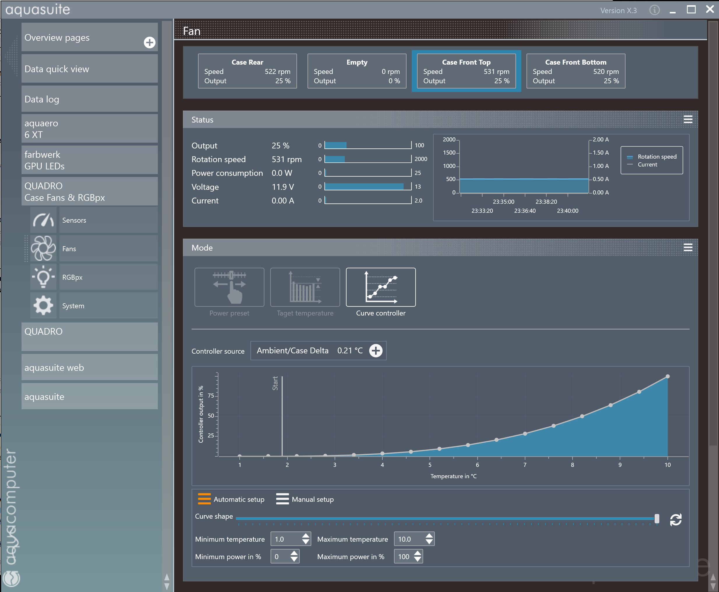

Each fan port on the quadro has a fan controller, which I believe go away when you move the fans to the aquaero with aquabus.
[attach]6922[/attach]
Yes, i realize that now. At first I thought all devices should be connected and controlled via Aquabus. While that does give you the convenience to control them from the same controller page within the Aquaero tab, the limited number of available curve controllers may be a deciding factor here. What I am thinking is that I should have my 2 Quadros as USB devices. That way I can set curve controllers for the pumps separate from the fans. I have about one liter of cooling fluid into each loop so I don’t need the fans to kick in every time my processor spikes for 5 seconds but I may want the pump speed up a little to move fluid away if CPU Package gets hot (as I am running a 9900k at 5.1 ghz on all cores fixed speed all the time this happens every time I move the mouse too fast ).
