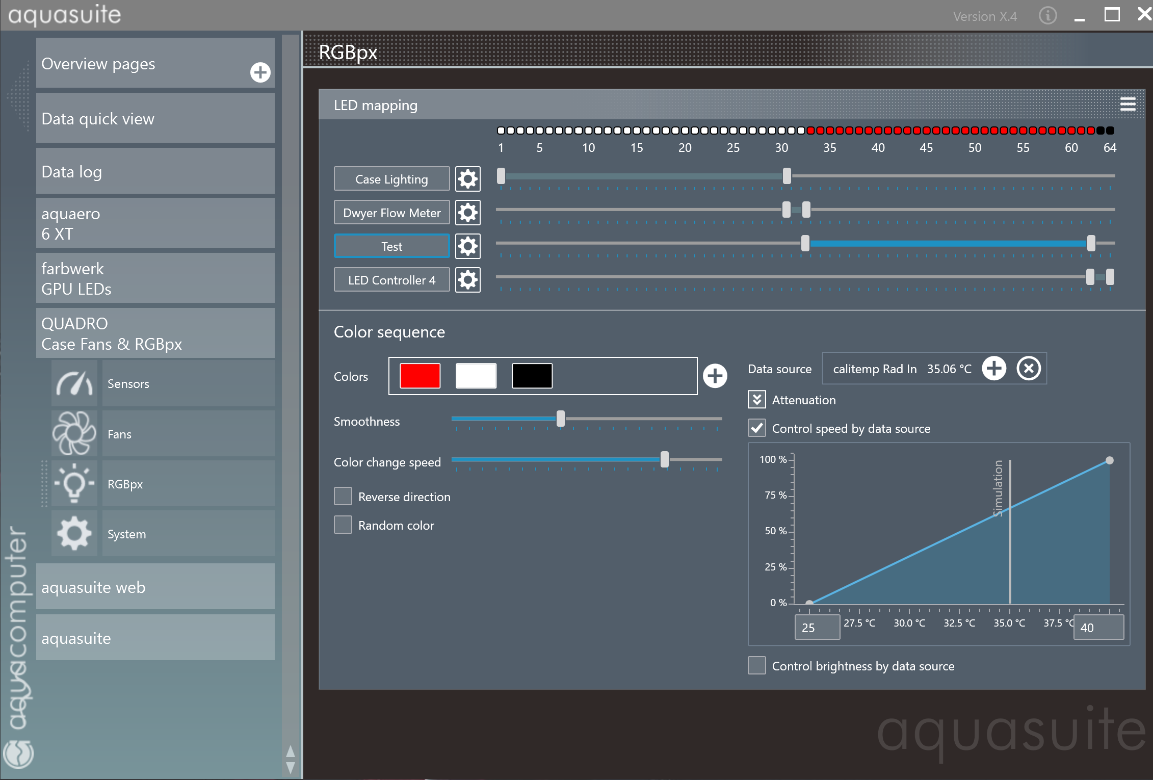

I do not have the farbwerk 360, but I do have a quadro, and I set a section of my rgbpx strips to run a color sequencer with roughly the same parameters as you did.
I saw the same thing as you, after a period the sequencer locked up while under the control of a data source for the speed.
When running the sequencer sans data source, it did not lock up for me.

The software sensor appears to be updating after the rgbpx strip ceases to change color.
It is the water inlet, so no large changes, but the decimal digits are updating in the LED Mapping panel.
Don't know if it matters, but the simulation strip at the top of the panel continues to update.
I have not tried other effects, but will do so. But first I will try a temp sensor plugged directly into a quadro temp input port.
Attached is the above setup with software sensor from water in, similar to war4peace.
